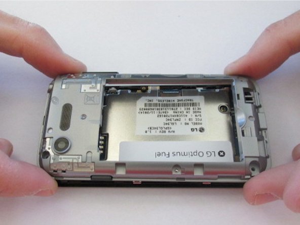

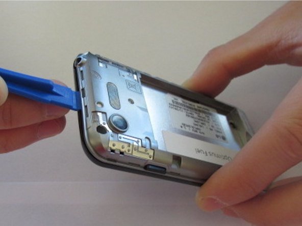

  3. LG Optimus Fuel Camera Replacement, Camera: crwdns2935265:03crwdnd2935265:01crwdnd2935265:03crwdne2935265:0 LG Optimus Fuel Camera Replacement, Camera: crwdns2935265:03crwdnd2935265:02crwdnd2935265:03crwdne2935265:0 LG Optimus Fuel Camera Replacement, Camera: crwdns2935265:03crwdnd2935265:03crwdnd2935265:03crwdne2935265:0
    • Remove the six 1.4mm screws using a Phillips head screwdriver with a size PH00 head and remove the back panel with a plastic opening tool.

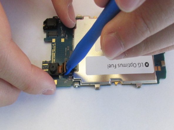

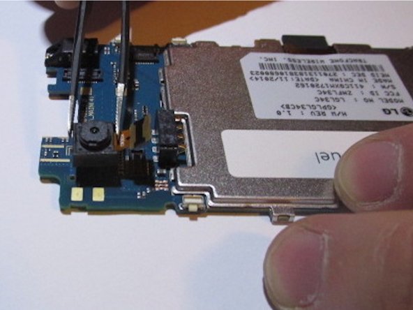

  4. LG Optimus Fuel Camera Replacement: crwdns2935265:04crwdnd2935265:01crwdnd2935265:03crwdne2935265:0 LG Optimus Fuel Camera Replacement: crwdns2935265:04crwdnd2935265:02crwdnd2935265:03crwdne2935265:0 LG Optimus Fuel Camera Replacement: crwdns2935265:04crwdnd2935265:03crwdnd2935265:03crwdne2935265:0
    • The camera has been secured to the circuit board using an adhesive. Use a plastic opening tool and precision tweezers to remove it. Don't be afraid to use a little force when pulling at the camera.
