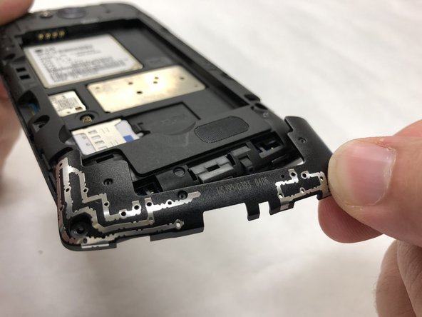

    • Hold the phone in your hand and position the small plastic opening tool or your finger under the lip of the phone by the USB port.
    • Pry or lift up on the indent with the opening tool.
    • Remove the back panel.

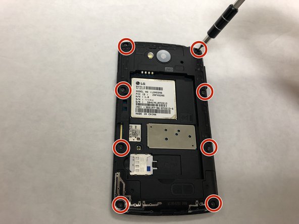

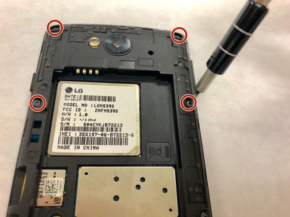

  3. LG Optimus F60 Speaker Replacement, Speaker: crwdns2935265:03crwdnd2935265:01crwdnd2935265:03crwdne2935265:0 LG Optimus F60 Speaker Replacement, Speaker: crwdns2935265:03crwdnd2935265:02crwdnd2935265:03crwdne2935265:0 LG Optimus F60 Speaker Replacement, Speaker: crwdns2935265:03crwdnd2935265:03crwdnd2935265:03crwdne2935265:0
    • Use the Phillips #000 screwdriver to remove eight screws.

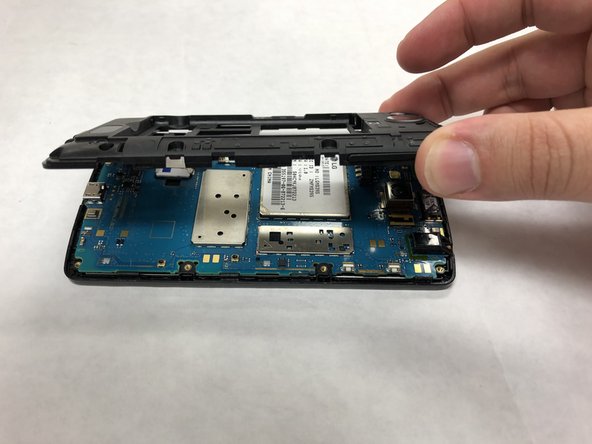

  4. LG Optimus F60 Speaker Replacement: crwdns2935265:04crwdnd2935265:01crwdnd2935265:02crwdne2935265:0 LG Optimus F60 Speaker Replacement: crwdns2935265:04crwdnd2935265:02crwdnd2935265:02crwdne2935265:0
    • Insert the iFixit opening tool in the indentation.
    • Pry the plastic using the opening tool to remove the lower back panel.
    • Remove the back panel from the device.

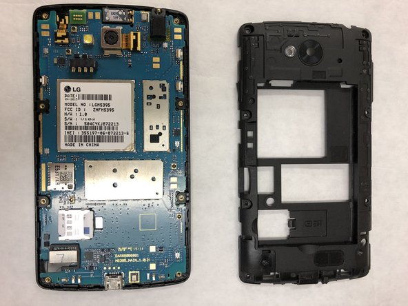

  5. LG Optimus F60 Speaker Replacement: crwdns2935265:05crwdnd2935265:01crwdnd2935265:03crwdne2935265:0 LG Optimus F60 Speaker Replacement: crwdns2935265:05crwdnd2935265:02crwdnd2935265:03crwdne2935265:0 LG Optimus F60 Speaker Replacement: crwdns2935265:05crwdnd2935265:03crwdnd2935265:03crwdne2935265:0
    • Start at the changing port, and continue to pry at the edges until loose enough to remove.

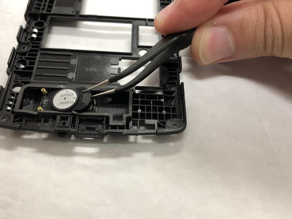

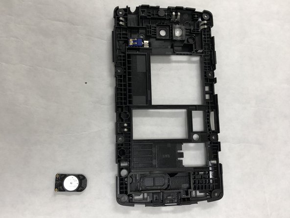

    • Gently pry the foam seal from around the speaker.
    • Pry out speaker using tweezers.
    • Remove and replace the speaker.
