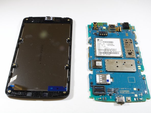

    1. LG Optimus F60 Screen Replacement, Screen: crwdns2935265:03crwdnd2935265:01crwdnd2935265:01crwdne2935265:0
      • Remove the eight 4 mm screws on the inner panel using the phillips #000 Screwdriver
    2. LG Optimus F60 Screen Replacement: crwdns2935265:04crwdnd2935265:01crwdnd2935265:01crwdne2935265:0
      • Remove bottom of inner panel.

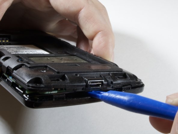

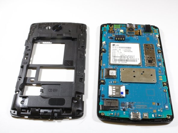

    3. LG Optimus F60 Screen Replacement: crwdns2935265:05crwdnd2935265:01crwdnd2935265:03crwdne2935265:0 LG Optimus F60 Screen Replacement: crwdns2935265:05crwdnd2935265:02crwdnd2935265:03crwdne2935265:0 LG Optimus F60 Screen Replacement: crwdns2935265:05crwdnd2935265:03crwdnd2935265:03crwdne2935265:0
      • Remove inner panel using plastic opening tool.
      • Apply force upwards while wiggling the tool further in.

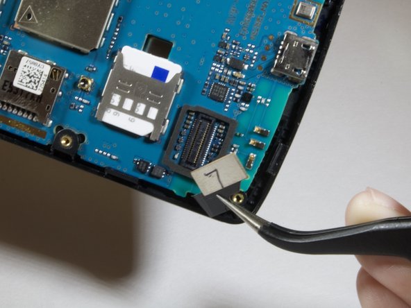

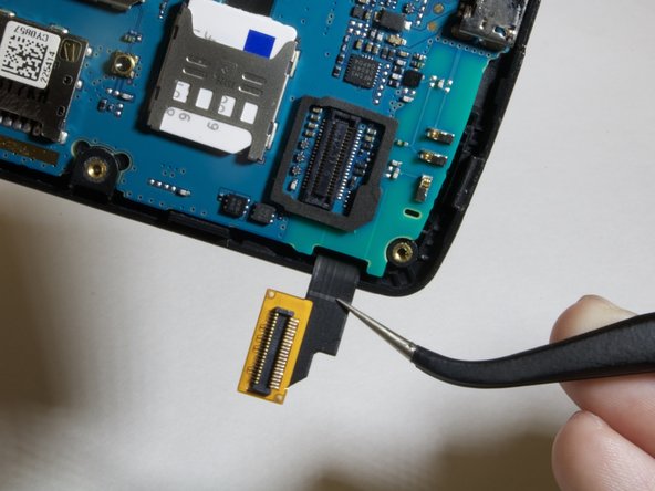

      • Unlatch Connector on bottom left of phone.
    5. LG Optimus F60 Screen Replacement: crwdns2935265:07crwdnd2935265:01crwdnd2935265:02crwdne2935265:0 LG Optimus F60 Screen Replacement: crwdns2935265:07crwdnd2935265:02crwdnd2935265:02crwdne2935265:0
      • Pull motherboard to detach digitizer from the motherboard
