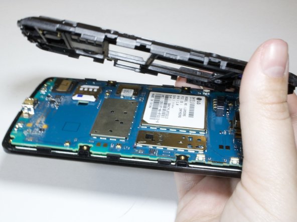

    1. LG Optimus F60 Power Button Replacement, Battery: crwdns2935265:01crwdnd2935265:01crwdnd2935265:03crwdne2935265:0 LG Optimus F60 Power Button Replacement, Battery: crwdns2935265:01crwdnd2935265:02crwdnd2935265:03crwdne2935265:0 LG Optimus F60 Power Button Replacement, Battery: crwdns2935265:01crwdnd2935265:03crwdnd2935265:03crwdne2935265:0
      • Hold the phone in your hand and position the small plastic opening tool or your finger under the lip of the phone by the USB port.
      • Pry or lift up on the indent with the opening tool.
      • Remove the back panel.

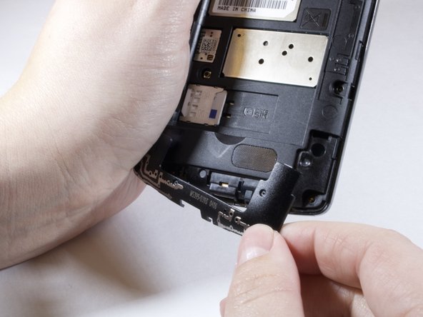

    2. LG Optimus F60 Power Button Replacement: crwdns2935265:02crwdnd2935265:01crwdnd2935265:03crwdne2935265:0 LG Optimus F60 Power Button Replacement: crwdns2935265:02crwdnd2935265:02crwdnd2935265:03crwdne2935265:0 LG Optimus F60 Power Button Replacement: crwdns2935265:02crwdnd2935265:03crwdnd2935265:03crwdne2935265:0
      • Place the small plastic opening tool or your finger at the indentation at the base of the battery.
      • Pry upwards or lift with your finger and remove battery.

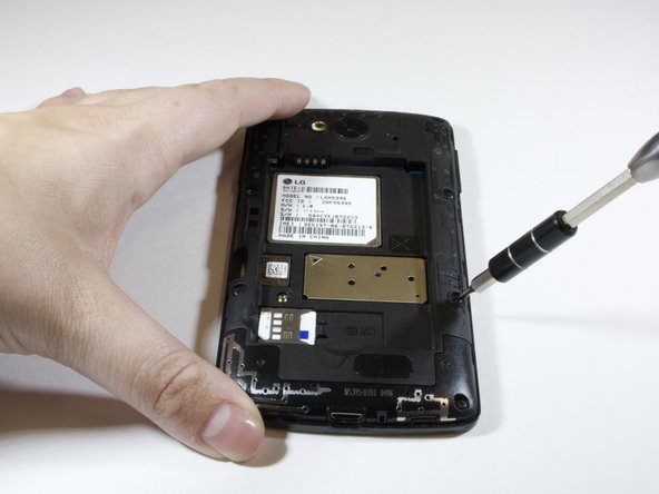

    1. LG Optimus F60 Power Button Replacement, Power Button: crwdns2935265:03crwdnd2935265:01crwdnd2935265:02crwdne2935265:0 LG Optimus F60 Power Button Replacement, Power Button: crwdns2935265:03crwdnd2935265:02crwdnd2935265:02crwdne2935265:0
      • Remove the eight 4 mm screws on the inner panel using the phillips #000 Screwdriver

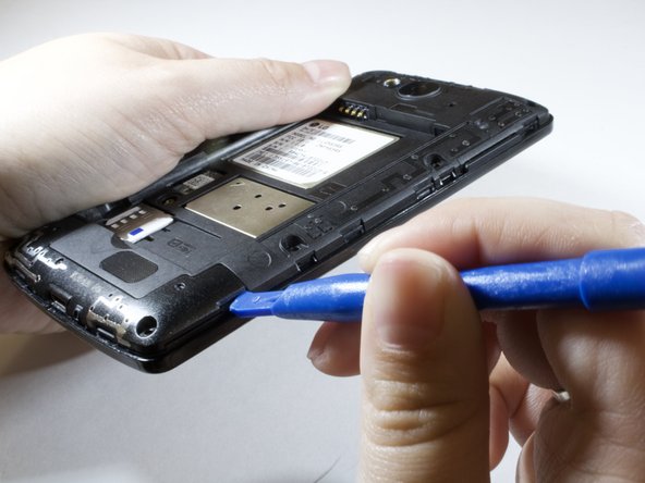

    2. LG Optimus F60 Power Button Replacement: crwdns2935265:04crwdnd2935265:01crwdnd2935265:03crwdne2935265:0 LG Optimus F60 Power Button Replacement: crwdns2935265:04crwdnd2935265:02crwdnd2935265:03crwdne2935265:0 LG Optimus F60 Power Button Replacement: crwdns2935265:04crwdnd2935265:03crwdnd2935265:03crwdne2935265:0
      • Remove inner panel using plastic opening tool.
      • Apply force upwards while wiggling the tool further in.
      • Remove bottom of inner panel.

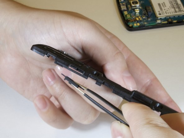

    3. LG Optimus F60 Power Button Replacement: crwdns2935265:05crwdnd2935265:01crwdnd2935265:03crwdne2935265:0 LG Optimus F60 Power Button Replacement: crwdns2935265:05crwdnd2935265:02crwdnd2935265:03crwdne2935265:0 LG Optimus F60 Power Button Replacement: crwdns2935265:05crwdnd2935265:03crwdnd2935265:03crwdne2935265:0
      • Use plastic opening tool to take off the inner pannel.
      • Take out faulty power button replace with new one.
