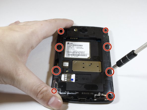

  3. LG Optimus F60 Front Camera Replacement, Front Camera: crwdns2935265:03crwdnd2935265:01crwdnd2935265:02crwdne2935265:0 LG Optimus F60 Front Camera Replacement, Front Camera: crwdns2935265:03crwdnd2935265:02crwdnd2935265:02crwdne2935265:0

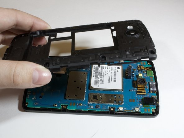

    • Use the phillips #000 Screwdriver to unscrew eight 4mm screws.

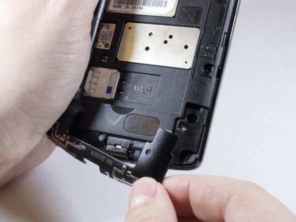

  4. LG Optimus F60 Front Camera Replacement: crwdns2935265:04crwdnd2935265:01crwdnd2935265:02crwdne2935265:0 LG Optimus F60 Front Camera Replacement: crwdns2935265:04crwdnd2935265:02crwdnd2935265:02crwdne2935265:0
    • Insert the plastic opening tool in the indentation marked by the red square.
    • Pry the plastic opening tool upwards to release the lower back panel.
    • Remove the lower back panel from the device.
  5. LG Optimus F60 Front Camera Replacement: crwdns2935265:05crwdnd2935265:01crwdnd2935265:03crwdne2935265:0 LG Optimus F60 Front Camera Replacement: crwdns2935265:05crwdnd2935265:02crwdnd2935265:03crwdne2935265:0 LG Optimus F60 Front Camera Replacement: crwdns2935265:05crwdnd2935265:03crwdnd2935265:03crwdne2935265:0

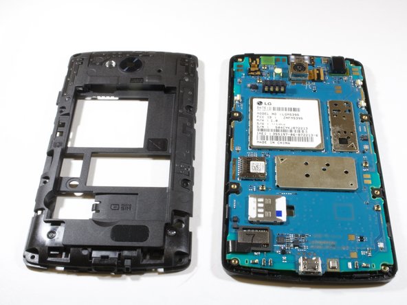

    • Continue moving plastic opening tool around device until back panel is loose enough to remove.
    • Remove the back panel

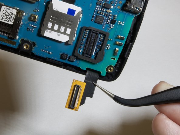

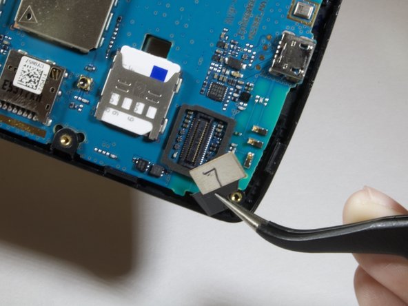

  6. LG Optimus F60 Front Camera Replacement: crwdns2935265:06crwdnd2935265:01crwdnd2935265:03crwdne2935265:0 LG Optimus F60 Front Camera Replacement: crwdns2935265:06crwdnd2935265:02crwdnd2935265:03crwdne2935265:0 LG Optimus F60 Front Camera Replacement: crwdns2935265:06crwdnd2935265:03crwdnd2935265:03crwdne2935265:0
    • Locate the digitizer connection on the lower left hand side of the device.
    • Use the tweezers to lift up and gently remove the connector.

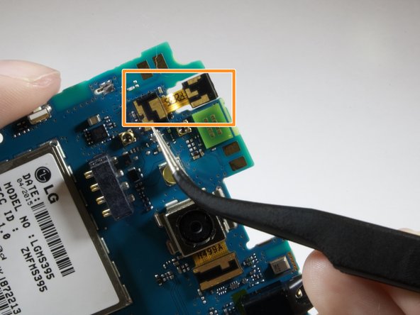

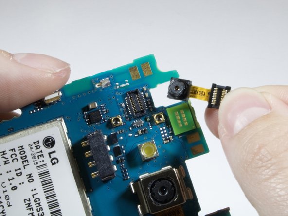

  7. LG Optimus F60 Front Camera Replacement: crwdns2935265:07crwdnd2935265:01crwdnd2935265:03crwdne2935265:0 LG Optimus F60 Front Camera Replacement: crwdns2935265:07crwdnd2935265:02crwdnd2935265:03crwdne2935265:0 LG Optimus F60 Front Camera Replacement: crwdns2935265:07crwdnd2935265:03crwdnd2935265:03crwdne2935265:0
    • Locate the front camera on the upper left hand side of the device. The camera is marked in red.
    • Use the tweezers to remove the front camera from the connector marked in orange.
    • Remove and replace front camera.
