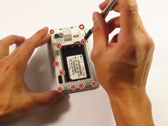

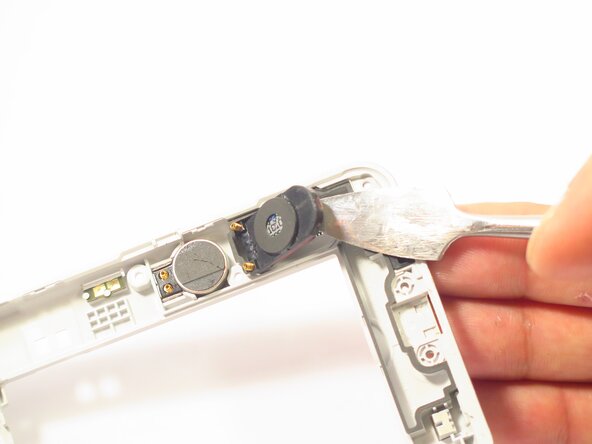

      • Remove rear battery cover and battery.
    2. LG Optimus F3 Speaker Replacement: crwdns2935265:02crwdnd2935265:01crwdnd2935265:01crwdne2935265:0
      • Remove the 10 holding screws on the rear case.
    3. LG Optimus F3 Speaker Replacement: crwdns2935265:03crwdnd2935265:01crwdnd2935265:01crwdne2935265:0

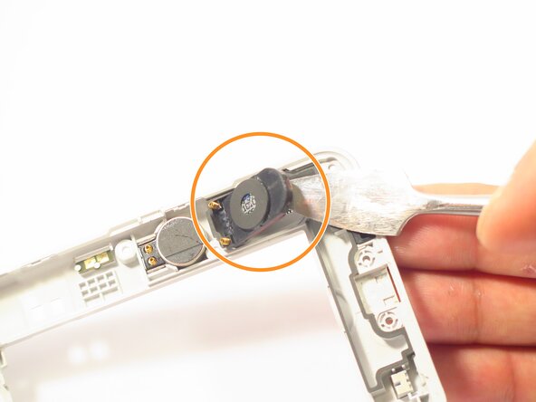

      • Remove the speaker using a spudger.
