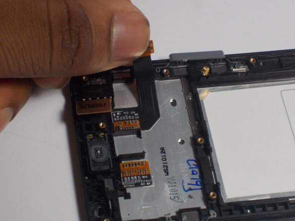

  5. LG Optimus Exceed 2 Home Button Replacement: crwdns2935265:05crwdnd2935265:01crwdnd2935265:02crwdne2935265:0 LG Optimus Exceed 2 Home Button Replacement: crwdns2935265:05crwdnd2935265:02crwdnd2935265:02crwdne2935265:0
    • Using the prying tool detach the connector on the device.
    • Insert the plastic opening tool underneath the connector and push tool down to lift the connector from the device.

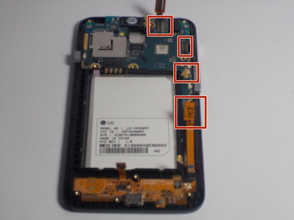

  7. LG Optimus Exceed 2 Home Button Replacement, Motherboard: crwdns2935265:07crwdnd2935265:01crwdnd2935265:02crwdne2935265:0 LG Optimus Exceed 2 Home Button Replacement, Motherboard: crwdns2935265:07crwdnd2935265:02crwdnd2935265:02crwdne2935265:0
    • Disconnect the remaining ribbon plugs and connectors. (Only remove the highlighted cables for the removal of the logic board.)

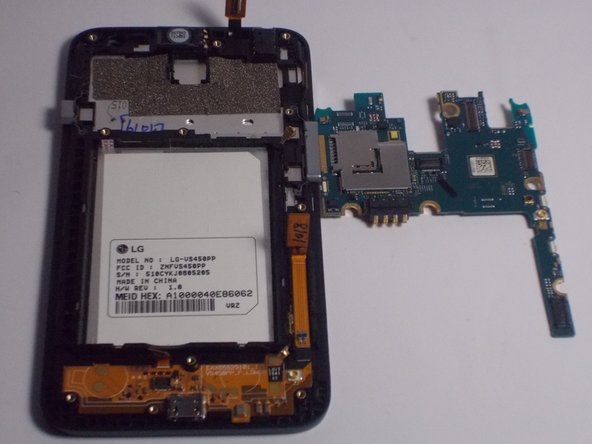

  8. LG Optimus Exceed 2 Home Button Replacement: crwdns2935265:08crwdnd2935265:01crwdnd2935265:02crwdne2935265:0 LG Optimus Exceed 2 Home Button Replacement: crwdns2935265:08crwdnd2935265:02crwdnd2935265:02crwdne2935265:0
    • Push the blue lifting tool up underneath the logic board and pull it upwards removing it from the device.

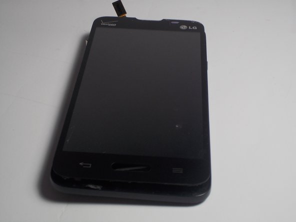

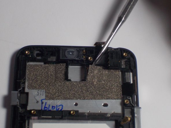

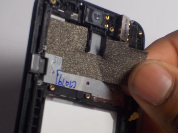

  9. LG Optimus Exceed 2 Home Button Replacement, Screen: crwdns2935265:09crwdnd2935265:01crwdnd2935265:03crwdne2935265:0 LG Optimus Exceed 2 Home Button Replacement, Screen: crwdns2935265:09crwdnd2935265:02crwdnd2935265:03crwdne2935265:0 LG Optimus Exceed 2 Home Button Replacement, Screen: crwdns2935265:09crwdnd2935265:03crwdnd2935265:03crwdne2935265:0
    • Using a prying tool, carefully remove the silver/ black tape used to hide the screens connectors.

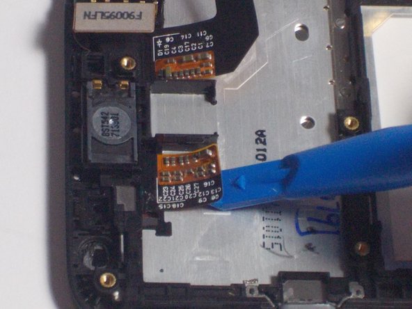

  10. LG Optimus Exceed 2 Home Button Replacement: crwdns2935265:010crwdnd2935265:01crwdnd2935265:03crwdne2935265:0 LG Optimus Exceed 2 Home Button Replacement: crwdns2935265:010crwdnd2935265:02crwdnd2935265:03crwdne2935265:0 LG Optimus Exceed 2 Home Button Replacement: crwdns2935265:010crwdnd2935265:03crwdnd2935265:03crwdne2935265:0
    • Using the blue lifting tool carefully remove the screens connectors.

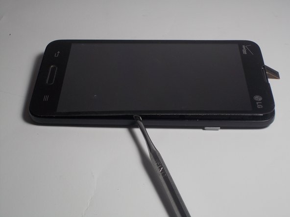

  11. LG Optimus Exceed 2 Home Button Replacement: crwdns2935265:011crwdnd2935265:01crwdnd2935265:03crwdne2935265:0 LG Optimus Exceed 2 Home Button Replacement: crwdns2935265:011crwdnd2935265:02crwdnd2935265:03crwdne2935265:0 LG Optimus Exceed 2 Home Button Replacement: crwdns2935265:011crwdnd2935265:03crwdnd2935265:03crwdne2935265:0
    • Flip the device so the screen faces you. Using a prying tool, at the corners on the screen begin to pry off the screen. (It will sound like tape being removed.) Avoid scratching the device with the prying tool.

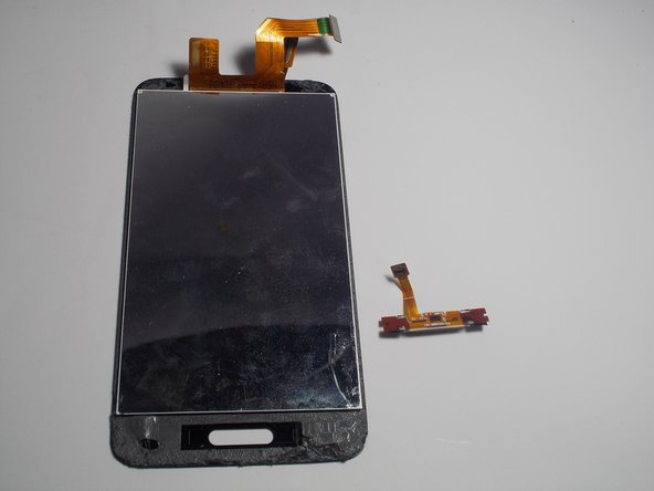

  12. LG Optimus Exceed 2 Home Button Replacement: crwdns2935265:012crwdnd2935265:01crwdnd2935265:01crwdne2935265:0
    • Pull the screen off of the body of the device. (Mind the circuits when removing the screen. The home button is likely to fall off. )

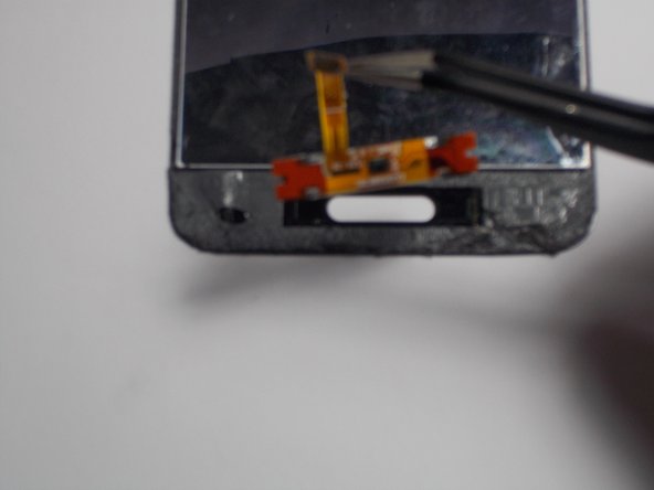

  14. LG Optimus Exceed 2 Home Button Replacement: crwdns2935265:014crwdnd2935265:01crwdnd2935265:03crwdne2935265:0 LG Optimus Exceed 2 Home Button Replacement: crwdns2935265:014crwdnd2935265:02crwdnd2935265:03crwdne2935265:0 LG Optimus Exceed 2 Home Button Replacement: crwdns2935265:014crwdnd2935265:03crwdnd2935265:03crwdne2935265:0
    • Using tweezers lift the home button to remove the home button from the device.
    • Do not yank the home button from the device as the home button connector may get damaged or break.
