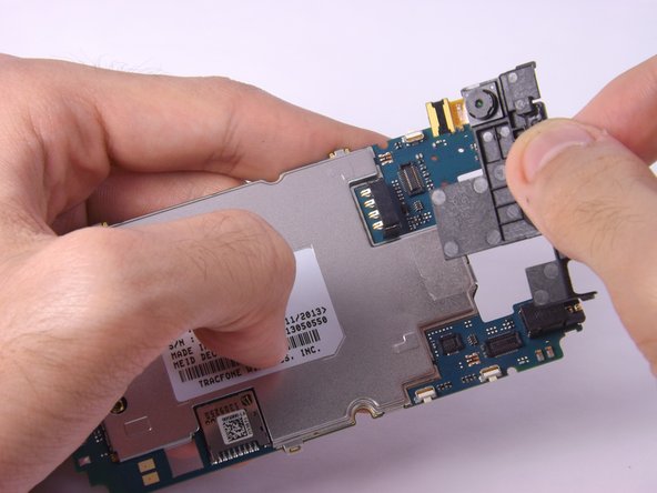

  8. LG Optimus Dynamic II L39C Camera Replacement, Detach tabs to separate the camera: crwdns2935265:08crwdnd2935265:01crwdnd2935265:02crwdne2935265:0 LG Optimus Dynamic II L39C Camera Replacement, Detach tabs to separate the camera: crwdns2935265:08crwdnd2935265:02crwdnd2935265:02crwdne2935265:0
    • Using the spudger, push the black tabs on the sides of the motherboard off carefully.
    • They should snap off easily.
  9. LG Optimus Dynamic II L39C Camera Replacement, Separate orange tab: crwdns2935265:09crwdnd2935265:01crwdnd2935265:01crwdne2935265:0
    • Turn the phone over and pull up the orange tab connected to the camera.
  10. LG Optimus Dynamic II L39C Camera Replacement, Separate the camera from the motherboard: crwdns2935265:010crwdnd2935265:01crwdnd2935265:02crwdne2935265:0 LG Optimus Dynamic II L39C Camera Replacement, Separate the camera from the motherboard: crwdns2935265:010crwdnd2935265:02crwdnd2935265:02crwdne2935265:0
    • You should be able to remove the camera easily with your fingers.
