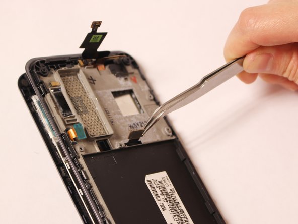

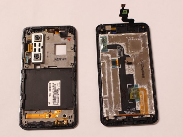

  15. LG Optimus 3D Screen Replacement, Pull Ribbon Cable End Through: crwdns2935265:015crwdnd2935265:01crwdnd2935265:02crwdne2935265:0 LG Optimus 3D Screen Replacement, Pull Ribbon Cable End Through: crwdns2935265:015crwdnd2935265:02crwdnd2935265:02crwdne2935265:0
    • There is a ribbon cable coming from the front portion of the phone that fits through a slot in the back.
    • Pull this ribbon cable through the slot to fully separate the halves.
  16. LG Optimus 3D Screen Replacement, LCD Removal: crwdns2935265:016crwdnd2935265:01crwdnd2935265:02crwdne2935265:0 LG Optimus 3D Screen Replacement, LCD Removal: crwdns2935265:016crwdnd2935265:02crwdnd2935265:02crwdne2935265:0
    • Gently pry the LCD from the phone half.
    • Don't touch the front of the LCD panel or the back of the digitizer (the clear panel).
    • If the glass on your phone is broken, be careful to avoid getting cut by any shards that may fall apart.
  17. LG Optimus 3D Screen Replacement, Note on Reassembly: crwdns2935265:017crwdnd2935265:01crwdnd2935265:02crwdne2935265:0 LG Optimus 3D Screen Replacement, Note on Reassembly: crwdns2935265:017crwdnd2935265:02crwdnd2935265:02crwdne2935265:0
    • When you are putting the front and back portions of the phone back together, make sure you don't forget to pull the LCD ribbon cable through the corresponding slot to connect back to the motherboard.
