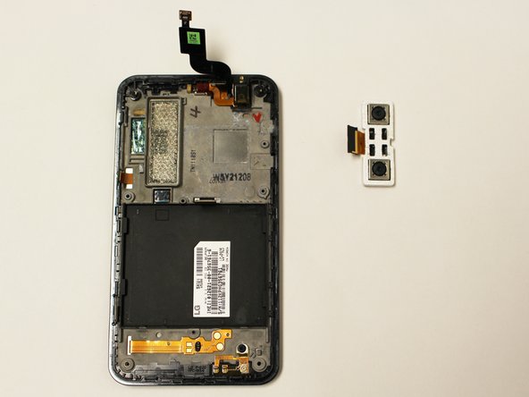

  9. LG Optimus 3D Rear Camera Replacement, Heat Adhesive: crwdns2935265:09crwdnd2935265:01crwdnd2935265:01crwdne2935265:0
    • Heat the camera assembly in 20-30 seconds intervals with a heat gun set on low, or a hair drying set on high.
    • Although the motherboard assembly has been removed in the picture, it is not necessary to remove it for camera removal.
  10. LG Optimus 3D Rear Camera Replacement, Remove Camera Assembly: crwdns2935265:010crwdnd2935265:01crwdnd2935265:02crwdne2935265:0 LG Optimus 3D Rear Camera Replacement, Remove Camera Assembly: crwdns2935265:010crwdnd2935265:02crwdnd2935265:02crwdne2935265:0
    • Using tweezers or a pry tool, gently wiggle and lift the camera assembly away from the body of the phone.
    • Although the motherboard has been removed in the pictures, it is not necessary to remove it before removing the camera.
