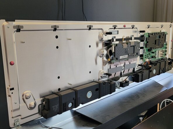

    • Unplug the TV and remove the rear cover
    • The power supply board has large capacitors which may have sufficient charge to cause an electric shock. Therefore wait a few minutes after disconnecting the mains plug before removing the circuit board.
    • Remove the power supply board. Remove the screws and remove the two connectors to the other circuit boards.

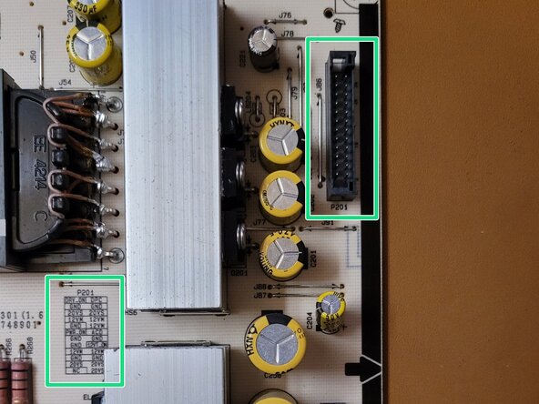

    • To find out whether the power supply unit is basically still working the standby voltage should first be checked
    • As soon as the mains plug is switched on dangerous mains voltage is present at several points. The circuit board should not be touched when plugged in.
    • Identify socket P201 and measure the voltage between pin 12VM and ground (GND). In standby mode the voltage should be approx. 7.8V.
    • An existing standby voltage of 7.8V does not automatically mean that the power supply board is working correctly. If the voltage is present but not enough current can be supplied to operate the TV in standby mode (red LED lights up) the fault is still with the power supply unit. However this can narrow down the cause.
