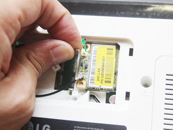

  5. LG Notebook LGC40 A410 WiFi module Replacement, Remove the antenna connectors: crwdns2935265:05crwdnd2935265:01crwdnd2935265:02crwdne2935265:0 LG Notebook LGC40 A410 WiFi module Replacement, Remove the antenna connectors: crwdns2935265:05crwdnd2935265:02crwdnd2935265:02crwdne2935265:0
    • Locate the antenna connectors on the WiFi module
    • Holding the antenna connectors with the tips of your fingers, carefully pull them out of the WiFi module board.
