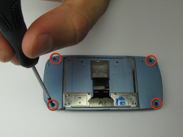

    • Using the pointed end of the spudger (or something sharp like a safety pin or push pin), remove the plastic screw covers along the corners of the phone.
    • Unscrew the four 3.5 mm screws that are underneath the covers.

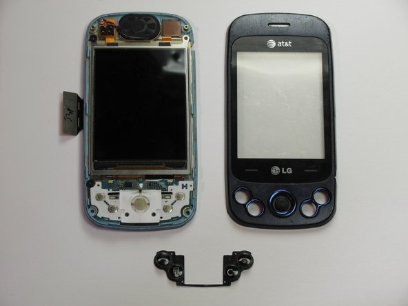

  10. LG Neon II Slider Mechanism Replacement: crwdns2935265:010crwdnd2935265:01crwdnd2935265:02crwdne2935265:0 LG Neon II Slider Mechanism Replacement: crwdns2935265:010crwdnd2935265:02crwdnd2935265:02crwdne2935265:0
    • Flip the phone over. Using the plastic opening tool, remove the front casing from the phone.
    • You should now be able to see the interior components of the screen.
    • When you pop the front panel off, the Call buttons will fall out.

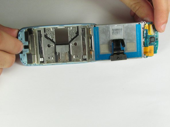

  12. LG Neon II Slider Mechanism Replacement: crwdns2935265:012crwdnd2935265:01crwdnd2935265:02crwdne2935265:0 LG Neon II Slider Mechanism Replacement: crwdns2935265:012crwdnd2935265:02crwdnd2935265:02crwdne2935265:0
    • Using the plastic opening tool, lift up the circuit board on the side opposite the speaker. This will reveal the sliding mechanism located under the screen.
    • The two halves of the phone will still be attached.
