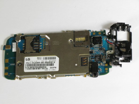

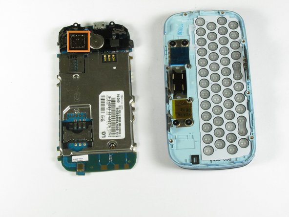

  7. LG Neon II Camera Replacement, Camera: crwdns2935265:07crwdnd2935265:01crwdnd2935265:02crwdne2935265:0 LG Neon II Camera Replacement, Camera: crwdns2935265:07crwdnd2935265:02crwdnd2935265:02crwdne2935265:0
    • Use the spudger to detach the metal rectangle from the keyboard panel.
    • The phone is now in two halves and the camera is visible.

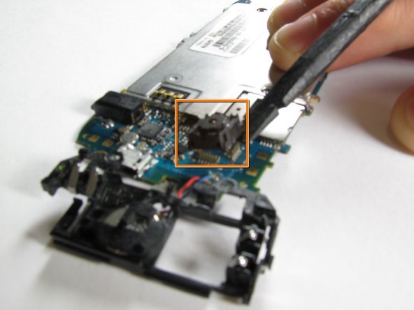

  8. LG Neon II Camera Replacement: crwdns2935265:08crwdnd2935265:01crwdnd2935265:02crwdne2935265:0 LG Neon II Camera Replacement: crwdns2935265:08crwdnd2935265:02crwdnd2935265:02crwdne2935265:0
    • Using the spudger, gently pry the black cover from around the camera.
    • The black cover should be opened up but not detached.
  9. LG Neon II Camera Replacement: crwdns2935265:09crwdnd2935265:01crwdnd2935265:02crwdne2935265:0 LG Neon II Camera Replacement: crwdns2935265:09crwdnd2935265:02crwdnd2935265:02crwdne2935265:0
    • Using the plastic opening tool, gently pry under the four metal edges around the camera to loosen it from the phone.
    • Once the camera is loose it can be removed from the phone and replaced with a new one.
