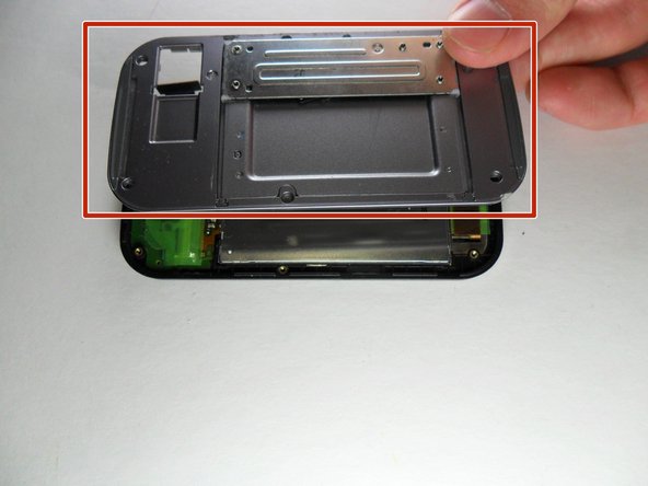

  4. LG Neon GT 365 Screen Replacement: crwdns2935265:04crwdnd2935265:01crwdnd2935265:02crwdne2935265:0 LG Neon GT 365 Screen Replacement: crwdns2935265:04crwdnd2935265:02crwdnd2935265:02crwdne2935265:0
    • Use the popping iFixit opening tool to go around the seam of the phone and slowly pull off the slide panel, making sure the ribbon connector does not get caught.

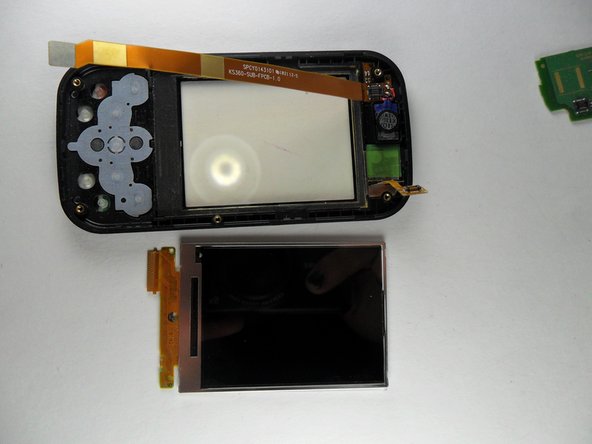

  10. LG Neon GT 365 Screen Replacement: crwdns2935265:010crwdnd2935265:01crwdnd2935265:02crwdne2935265:0 LG Neon GT 365 Screen Replacement: crwdns2935265:010crwdnd2935265:02crwdnd2935265:02crwdne2935265:0
    • Once the silver LCD has been lifted up slightly slide the bottom half of the green circuit board off the phone by pulling down on it.
    • After the green circuit board is removed you will be able to pop the screen out. Grab a new screen and slide it in to replace it!
    • Follow the instructions in reverse to reassemble the phone with your new screen.
