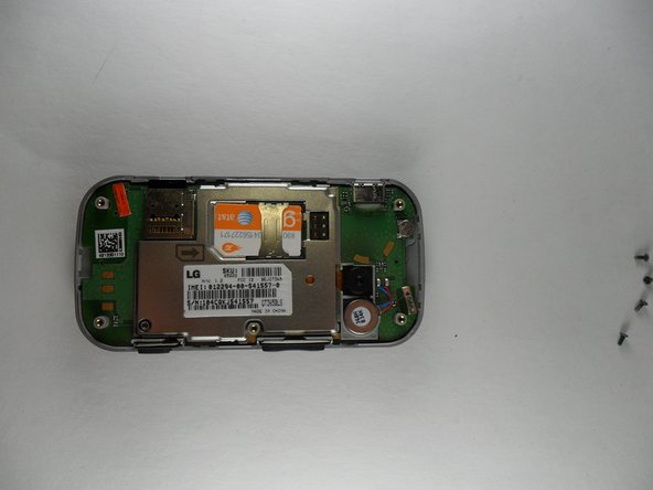

    • Remove 5 screws, 1 from each corner of the phone and 1 from the center-right of the phone.
  3. LG Neon GT 365 Keyboard Replacement: crwdns2935265:03crwdnd2935265:01crwdnd2935265:02crwdne2935265:0 LG Neon GT 365 Keyboard Replacement: crwdns2935265:03crwdnd2935265:02crwdnd2935265:02crwdne2935265:0
    • Now pull off the rear casing, using an opening tool. **Buttons for volume and pictures may fall out**
