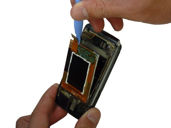

    • Insert a spudger between the black and grey casings and gently spread them apart.
    • Work around the device gradually, opening the gap further.

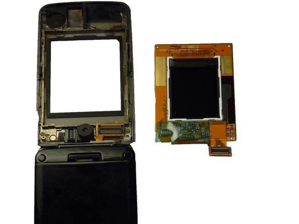

  3. LG Muziq LX570 Display Panel Replacement: crwdns2935265:03crwdnd2935265:01crwdnd2935265:03crwdne2935265:0 LG Muziq LX570 Display Panel Replacement: crwdns2935265:03crwdnd2935265:02crwdnd2935265:03crwdne2935265:0 LG Muziq LX570 Display Panel Replacement: crwdns2935265:03crwdnd2935265:03crwdnd2935265:03crwdne2935265:0
    • Caution: The wires and ribbon connector can break easily. Exhibit care when removing them.
    • Use the spudger and lift upward to disconnect the ribbon from the main part of the phone.
    • Carefully remove any parts stuck to the front case such as speakers.

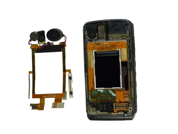

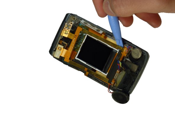

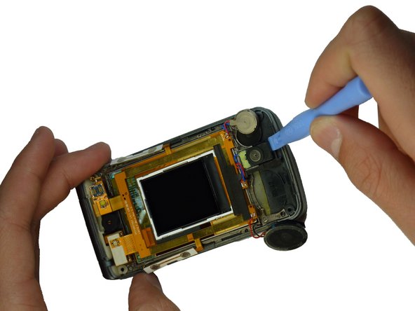

  4. LG Muziq LX570 Display Panel Replacement, Display Panel: crwdns2935265:04crwdnd2935265:01crwdnd2935265:03crwdne2935265:0 LG Muziq LX570 Display Panel Replacement, Display Panel: crwdns2935265:04crwdnd2935265:02crwdnd2935265:03crwdne2935265:0 LG Muziq LX570 Display Panel Replacement, Display Panel: crwdns2935265:04crwdnd2935265:03crwdnd2935265:03crwdne2935265:0
    • Use the spudger to unclip the two upper wiring connections.

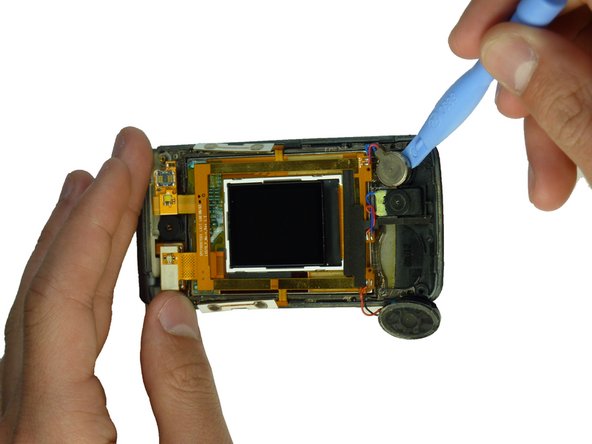

  5. LG Muziq LX570 Display Panel Replacement: crwdns2935265:05crwdnd2935265:01crwdnd2935265:02crwdne2935265:0 LG Muziq LX570 Display Panel Replacement: crwdns2935265:05crwdnd2935265:02crwdnd2935265:02crwdne2935265:0
    • Caution: The side buttons are attached to the ribbon around the display screen. Do not separate the side buttons from the ribbon when removing.
    • Gently lift the side buttons from the phone casing.

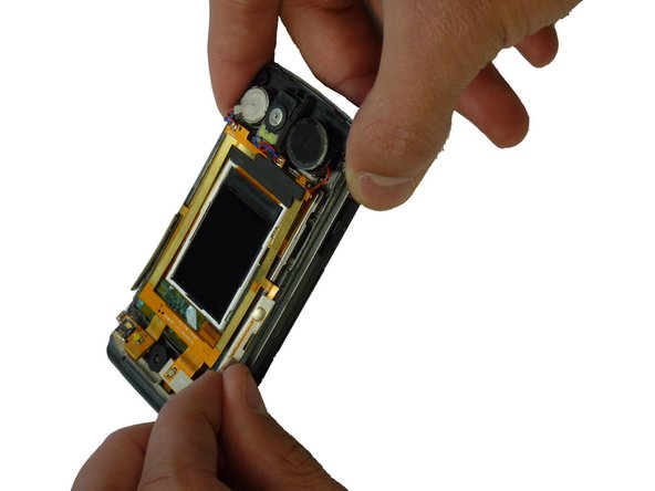

  6. LG Muziq LX570 Display Panel Replacement: crwdns2935265:06crwdnd2935265:01crwdnd2935265:03crwdne2935265:0 LG Muziq LX570 Display Panel Replacement: crwdns2935265:06crwdnd2935265:02crwdnd2935265:03crwdne2935265:0 LG Muziq LX570 Display Panel Replacement: crwdns2935265:06crwdnd2935265:03crwdnd2935265:03crwdne2935265:0
    • Caution: The wiring on the ribbon connector is delicate. Do not excessively pull on the wires.
    • Use the spudger to remove the three components connected to the ribbon.
  7. LG Muziq LX570 Display Panel Replacement: crwdns2935265:07crwdnd2935265:01crwdnd2935265:03crwdne2935265:0 LG Muziq LX570 Display Panel Replacement: crwdns2935265:07crwdnd2935265:02crwdnd2935265:03crwdne2935265:0 LG Muziq LX570 Display Panel Replacement: crwdns2935265:07crwdnd2935265:03crwdnd2935265:03crwdne2935265:0
    • Caution: The ribbon contains important wiring and is glued to the phone. Be careful when removing the ribbon.
    • Use the spudger to gently remove the ribbon from the phone.
  8. LG Muziq LX570 Display Panel Replacement: crwdns2935265:08crwdnd2935265:01crwdnd2935265:03crwdne2935265:0 LG Muziq LX570 Display Panel Replacement: crwdns2935265:08crwdnd2935265:02crwdnd2935265:03crwdne2935265:0 LG Muziq LX570 Display Panel Replacement: crwdns2935265:08crwdnd2935265:03crwdnd2935265:03crwdne2935265:0
    • Use the spudger to lift the upper tab in the top left corner of the display.
    • Continue lifting until the display panels lift out of their setting and can be removed.
