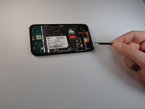

  3. LG Motion 4G MS770 Volume Buttons Replacement, Remove screws.: crwdns2935265:03crwdnd2935265:01crwdnd2935265:01crwdne2935265:0
    • Use a Phillips #00 Screwdriver to remove all eight 4mm screws.
  4. LG Motion 4G MS770 Volume Buttons Replacement: crwdns2935265:04crwdnd2935265:01crwdnd2935265:02crwdne2935265:0 LG Motion 4G MS770 Volume Buttons Replacement: crwdns2935265:04crwdnd2935265:02crwdnd2935265:02crwdne2935265:0
    • Use a plastic opening tool to remove the back trim by working around all of the edges.
  5. LG Motion 4G MS770 Volume Buttons Replacement: crwdns2935265:05crwdnd2935265:01crwdnd2935265:02crwdne2935265:0 LG Motion 4G MS770 Volume Buttons Replacement: crwdns2935265:05crwdnd2935265:02crwdnd2935265:02crwdne2935265:0
    • Remove the volume buttons from the side.
