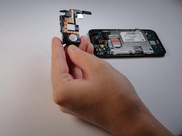

  6. LG Motion 4G MS770 Rear Facing Camera Replacement, Speaker: crwdns2935265:06crwdnd2935265:01crwdnd2935265:02crwdne2935265:0 LG Motion 4G MS770 Rear Facing Camera Replacement, Speaker: crwdns2935265:06crwdnd2935265:02crwdnd2935265:02crwdne2935265:0
    • Use a plastic opening tool to lift the speaker off by prying under the silver square as shown.
    • Note: There is a small tab underneath the speaker that will be lifted off when the speaker is removed.
