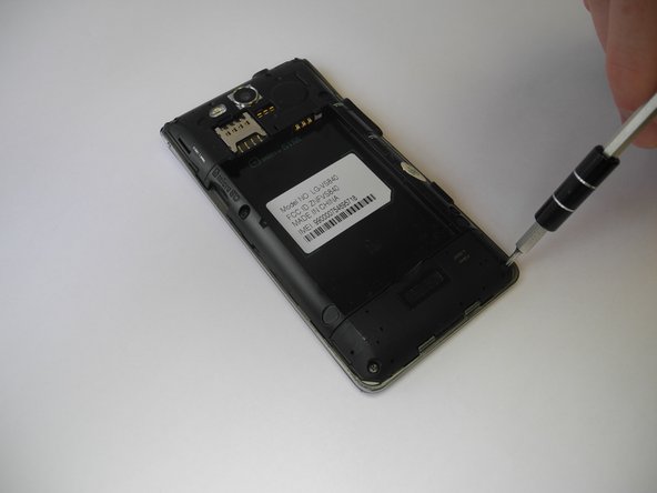

    • Begin by removing the seven Phillip's head screws on the back of the phone.

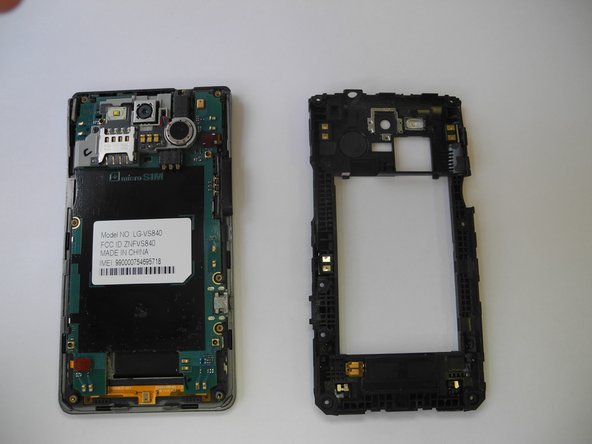

  5. LG Lucid 4G LCD Replacement: crwdns2935265:05crwdnd2935265:01crwdnd2935265:02crwdne2935265:0 LG Lucid 4G LCD Replacement: crwdns2935265:05crwdnd2935265:02crwdnd2935265:02crwdne2935265:0
    • Use the small notches along the sides of the phone to help you pry the back plate off and help stop the pry tool from slipping.
    • Use the plastic pry tool and begin working your way around the sides of the phone.
    • Some force may be required during this step.

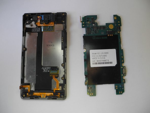

  8. LG Lucid 4G LCD Replacement: crwdns2935265:08crwdnd2935265:01crwdnd2935265:02crwdne2935265:0 LG Lucid 4G LCD Replacement: crwdns2935265:08crwdnd2935265:02crwdnd2935265:02crwdne2935265:0
    • Release the five flex connectors on the motherboard.
    • The camera may fall off during this step. That is okay! Set it aside for reassembly.
    • Once all five flex connectors are released, simply lift the motherboard to separate it from the rest of the phone.

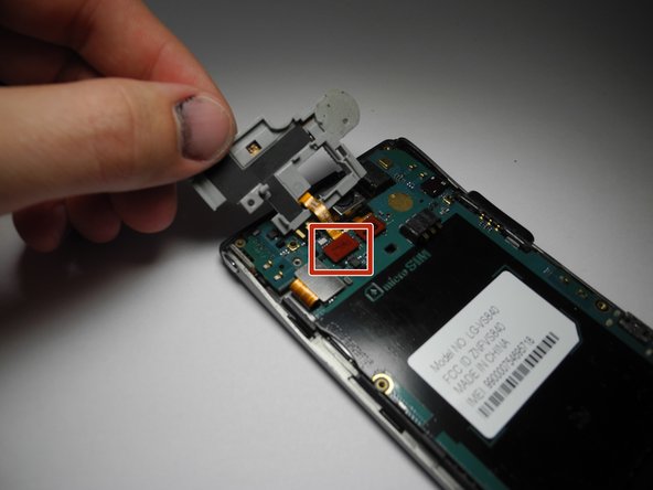

  9. LG Lucid 4G LCD Replacement: crwdns2935265:09crwdnd2935265:01crwdnd2935265:01crwdne2935265:0
    • If the camera did not fall off during step five, you must remove it now by gently lifting it. It is attached by a small amount of adhesive and should detach easily.
    • Gently lift the headphone jack assembly to reveal the touch screen digitizer flex cable.
    • Release the touch screen digitizer flex cable connector.

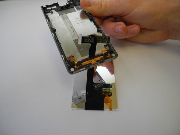

  11. LG Lucid 4G LCD Replacement: crwdns2935265:011crwdnd2935265:01crwdnd2935265:02crwdne2935265:0 LG Lucid 4G LCD Replacement: crwdns2935265:011crwdnd2935265:02crwdnd2935265:02crwdne2935265:0
    • The final step is to remove the LCD screen from its housing. Begin by gently peeling the ribbon from the back of the housing.
    • Once the ribbon is fully detached, carefully feed it through the bottom of the display housing.
    • Once this is done the LCD screen assembly will have been separated from the phone.
