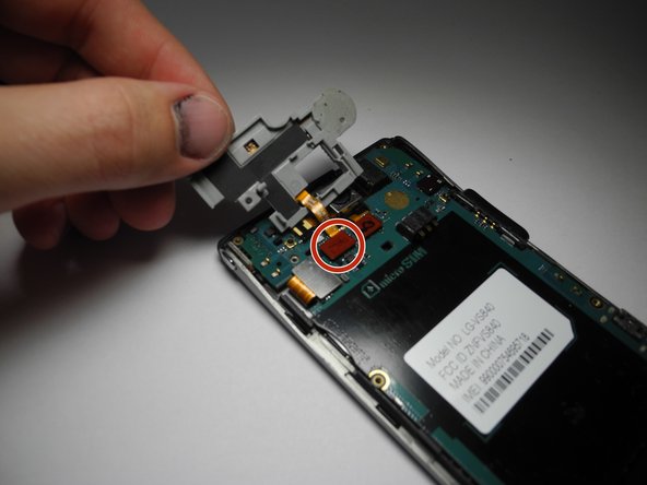

  6. LG Lucid 4G Headphone Jack Replacement: crwdns2935265:06crwdnd2935265:01crwdnd2935265:01crwdne2935265:0
    • Next, remove another screw located in top left quadrant of phone.
  7. LG Lucid 4G Headphone Jack Replacement: crwdns2935265:07crwdnd2935265:01crwdnd2935265:02crwdne2935265:0 LG Lucid 4G Headphone Jack Replacement: crwdns2935265:07crwdnd2935265:02crwdnd2935265:02crwdne2935265:0
    • Remove SIM card holding by prying it with opening tool. As you are lifting it, disconnect the ribbon that is connecting the sim card holding and the rest of the phone.

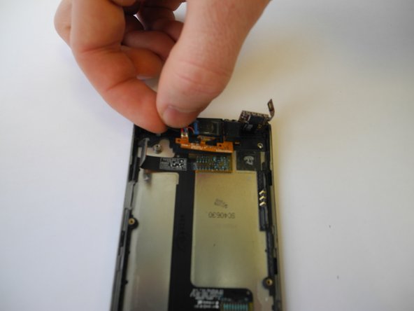

  9. LG Lucid 4G Headphone Jack Replacement: crwdns2935265:09crwdnd2935265:01crwdnd2935265:02crwdne2935265:0 LG Lucid 4G Headphone Jack Replacement: crwdns2935265:09crwdnd2935265:02crwdnd2935265:02crwdne2935265:0
    • Lift the additional ribbon in the top right quadrant.
    • Once that ribbon is lifted, the audio jack can easily be removed.
