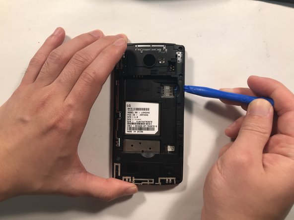

    • Flip phone to the back so you can access back of the phone which holds the battery.
  2. LG Leon LTE Earpiece Speaker Replacement: crwdns2935265:02crwdnd2935265:01crwdnd2935265:03crwdne2935265:0 LG Leon LTE Earpiece Speaker Replacement: crwdns2935265:02crwdnd2935265:02crwdnd2935265:03crwdne2935265:0 LG Leon LTE Earpiece Speaker Replacement: crwdns2935265:02crwdnd2935265:03crwdnd2935265:03crwdne2935265:0
    • Pry the back of the phone open in the incision area at the bottom of the phone with your opening tool in an upward direction to retrieve access to the battery.

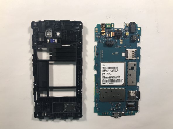

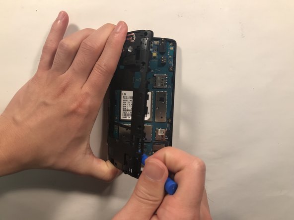

    • Once the back is removed you will have access to the 8 screws that need to be unscrewed with the Phillips #0 screwdriver. Once all screws are free use the opening tool to pry the back frame of the phone apart.
  4. LG Leon LTE Earpiece Speaker Replacement: crwdns2935265:04crwdnd2935265:01crwdnd2935265:02crwdne2935265:0 LG Leon LTE Earpiece Speaker Replacement: crwdns2935265:04crwdnd2935265:02crwdnd2935265:02crwdne2935265:0
    • At this point you should have access to the motherboard.

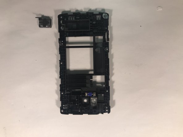

    • Use opening tool to get the earpiece.
