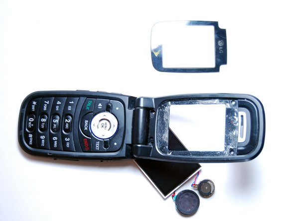

    • Use the spudger to pry out the indicated rubber squares.
    • Use the #0 Phillips screwdriver to take out the revealed screws.
  2. LG LX150 Screen Replacement: crwdns2935265:02crwdnd2935265:01crwdnd2935265:03crwdne2935265:0 LG LX150 Screen Replacement: crwdns2935265:02crwdnd2935265:02crwdnd2935265:03crwdne2935265:0 LG LX150 Screen Replacement: crwdns2935265:02crwdnd2935265:03crwdnd2935265:03crwdne2935265:0
    • Carefully lodge the spudger between the face plate and the hinge mechanism.
    • Gently pry the face plate until it releases from place holders.
  3. LG LX150 Screen Replacement, Screen: crwdns2935265:03crwdnd2935265:01crwdnd2935265:02crwdne2935265:0 LG LX150 Screen Replacement, Screen: crwdns2935265:03crwdnd2935265:02crwdnd2935265:02crwdne2935265:0
    • Apply even amounts of force upon removing screen, otherwise cracking may occur.
    • Gently loosen the screen from its adhesive by pressing around the screen's rear perimeter with a spudger. Place upward pressure in crevices between face plate and screen.
    • Carefully use both thumbs and apply pressure to the back of the screen to pop out.
