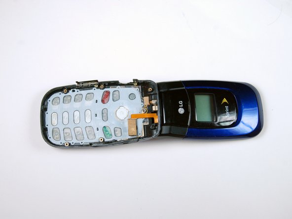

  6. LG LX150 Motherboard Replacement, Motherboard: crwdns2935265:06crwdnd2935265:01crwdnd2935265:01crwdne2935265:0
    • Lift the motherboard from the bottom to loosen it.
  7. LG LX150 Motherboard Replacement: crwdns2935265:07crwdnd2935265:01crwdnd2935265:01crwdne2935265:0
    • Remove the pin socket that connects the screen to the motherboard by pulling up away from the motherboard.
  8. LG LX150 Motherboard Replacement: crwdns2935265:08crwdnd2935265:01crwdnd2935265:02crwdne2935265:0 LG LX150 Motherboard Replacement: crwdns2935265:08crwdnd2935265:02crwdnd2935265:02crwdne2935265:0
    • Remove the motherboard.
    • The keypad will now be visible, as shown in the second picture.
