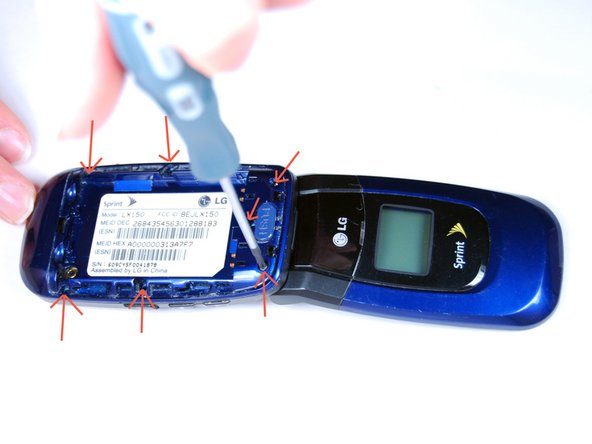

  4. LG LX150 Internal Back Cover Replacement, Internal Back Cover: crwdns2935265:04crwdnd2935265:01crwdnd2935265:03crwdne2935265:0 LG LX150 Internal Back Cover Replacement, Internal Back Cover: crwdns2935265:04crwdnd2935265:02crwdnd2935265:03crwdne2935265:0 LG LX150 Internal Back Cover Replacement, Internal Back Cover: crwdns2935265:04crwdnd2935265:03crwdnd2935265:03crwdne2935265:0
    • Remove the 7 phillips screws indicated by the red arrows using the phillips #0 screwdriver.

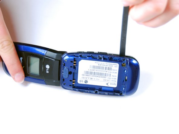

    • Insert the flat end of the spudger in-between the black and blue phone casing on the side of the phone and split the the blue and black apart. Work your way around the perimeter of the cover, loosening all corners.

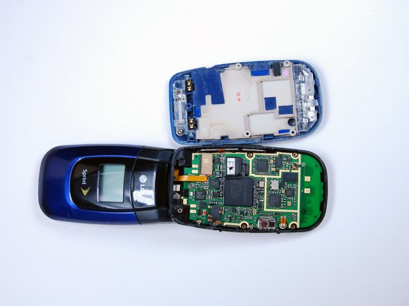

    • Remove the internal back cover after loosening all the corners.
    • The second picture below is what you will see after removing the internal back cover.
