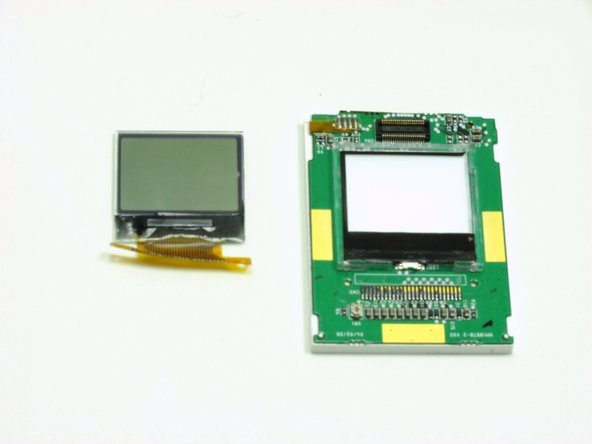

  11. LG L1200 Outer LCD Screen Replacement, Outer LCD Screen: crwdns2935265:011crwdnd2935265:01crwdnd2935265:01crwdne2935265:0
    • The outer LCD screen can be found on the circuit board, which is attached to the back of the inner LCD screen.
  12. LG L1200 Outer LCD Screen Replacement: crwdns2935265:012crwdnd2935265:01crwdnd2935265:02crwdne2935265:0 LG L1200 Outer LCD Screen Replacement: crwdns2935265:012crwdnd2935265:02crwdnd2935265:02crwdne2935265:0
    • Use an IPod opening tool to carefully lift the screen from its backing.
    • Use your finger to pull the screen forward.
  13. LG L1200 Outer LCD Screen Replacement: crwdns2935265:013crwdnd2935265:01crwdnd2935265:02crwdne2935265:0 LG L1200 Outer LCD Screen Replacement: crwdns2935265:013crwdnd2935265:02crwdnd2935265:02crwdne2935265:0
    • Pull the screen and the tape ribbon off the circuit board.
