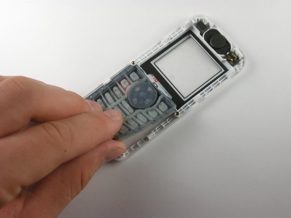

  7. LG KP100 Keypad Replacement, Keypad: crwdns2935265:07crwdnd2935265:01crwdnd2935265:02crwdne2935265:0 LG KP100 Keypad Replacement, Keypad: crwdns2935265:07crwdnd2935265:02crwdnd2935265:02crwdne2935265:0
    • As you can see, the rubber keypad is attached to the front casing. Gently remove it from the case by pinching any part of it and lifting. Don't worry, it isn't attached too firmly and is easily removable.
