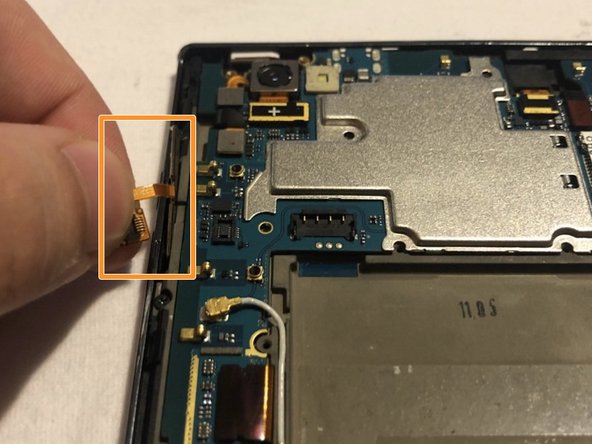

  9. LG Intuition Volume Buttons Replacement, Volume Buttons: crwdns2935265:09crwdnd2935265:01crwdnd2935265:02crwdne2935265:0 LG Intuition Volume Buttons Replacement, Volume Buttons: crwdns2935265:09crwdnd2935265:02crwdnd2935265:02crwdne2935265:0
    • Carefully use the plastic opening tool to pry the ribbon cable connecting the battery to the motherboard of the phone.
    • Slowly pull the ribbon cable upward releasing the volume buttons from the phone.
