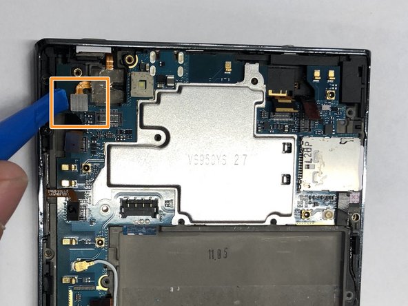

  9. LG Intuition Screen Protector Replacement, Camera: crwdns2935265:09crwdnd2935265:01crwdnd2935265:01crwdne2935265:0
    • Carefully use the plastic opening tool to pry the ribbon cable below the camera itself from the motherboard.
  10. LG Intuition Screen Protector Replacement: crwdns2935265:010crwdnd2935265:01crwdnd2935265:01crwdne2935265:0
    • Using the ribbon beneath the camera lift it upwards and pull the camera out.

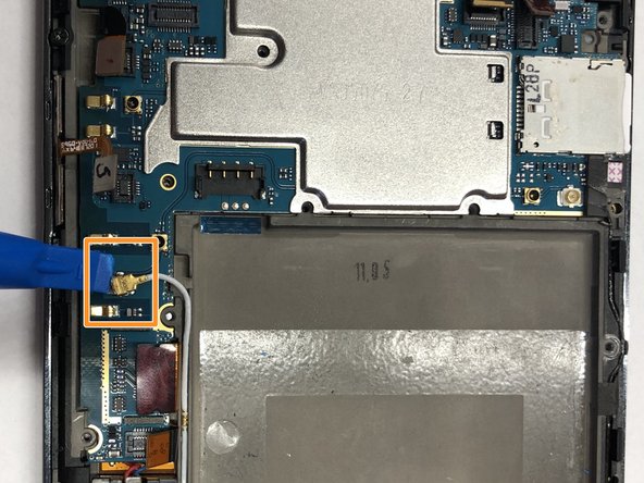

  13. LG Intuition Screen Protector Replacement: crwdns2935265:013crwdnd2935265:01crwdnd2935265:02crwdne2935265:0 LG Intuition Screen Protector Replacement: crwdns2935265:013crwdnd2935265:02crwdnd2935265:02crwdne2935265:0
    • Carefully use the plastic opening tool to pry the wire that connects to the bottom home and back display buttons.
    • Carefully use the plastic opening tool to pry the second wire on the right side of the battery that also connects to the bottom home and back display buttons.

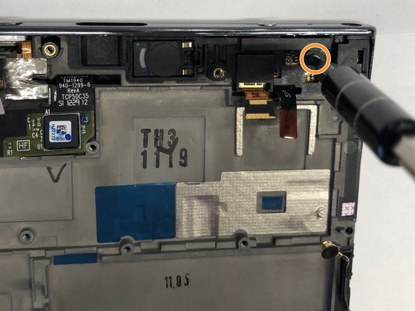

  15. LG Intuition Screen Protector Replacement: crwdns2935265:015crwdnd2935265:01crwdnd2935265:02crwdne2935265:0 LG Intuition Screen Protector Replacement: crwdns2935265:015crwdnd2935265:02crwdnd2935265:02crwdne2935265:0
    • Remove the 5mm Phillips #00 screw below the volume buttons holding the plastic shield onto the screen display.
    • Remove the 5mm Phillips #00 screw on the top right of the phone.
