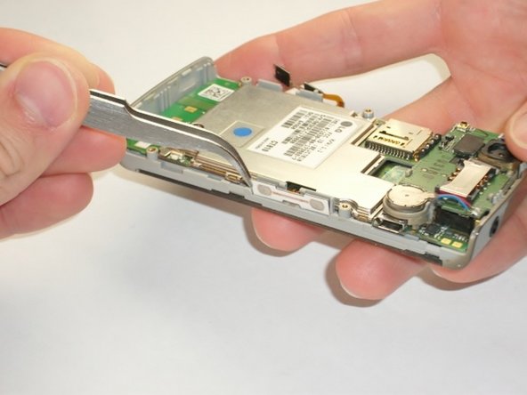

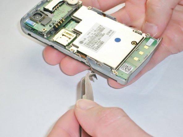

    1. LG Incite Touch Screen Replacement, Motherboard: crwdns2935265:07crwdnd2935265:01crwdnd2935265:03crwdne2935265:0 LG Incite Touch Screen Replacement, Motherboard: crwdns2935265:07crwdnd2935265:02crwdnd2935265:03crwdne2935265:0 LG Incite Touch Screen Replacement, Motherboard: crwdns2935265:07crwdnd2935265:03crwdnd2935265:03crwdne2935265:0
      • Use the metal tweezers to gently peel the yellow tab from the left edge of the phone at the two plastic bases.
      • Do not completely remove the tab from the body, it should still be connected to the phone by the orange plastic.
      • Repeat this for the white tab on the opposite side of the phone.
      • This tab also has two plastic bases adhering it to the edge of the phone.

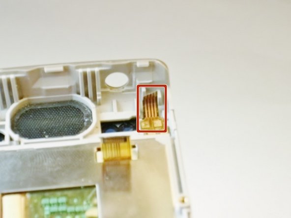

    2. LG Incite Touch Screen Replacement: crwdns2935265:08crwdnd2935265:01crwdnd2935265:01crwdne2935265:0
      • Insert your plastic opening tool underneath the speaker/camera panel, and gently pry it upwards.
      • Do not fully remove the panel! It should still be attached to the motherboard by a red and black wire.

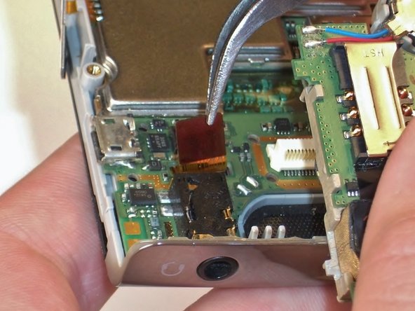

    3. LG Incite Touch Screen Replacement: crwdns2935265:09crwdnd2935265:01crwdnd2935265:02crwdne2935265:0 LG Incite Touch Screen Replacement: crwdns2935265:09crwdnd2935265:02crwdnd2935265:02crwdne2935265:0
      • Use the metal tweezers to gently lift the edge of the maroon tab, it should pop up easily.
      • Do not remove the tab completely, it should still be connected to the phone.
