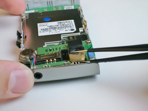

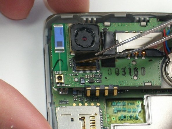

  7. LG Incite Camera Replacement, Camera: crwdns2935265:07crwdnd2935265:01crwdnd2935265:02crwdne2935265:0 LG Incite Camera Replacement, Camera: crwdns2935265:07crwdnd2935265:02crwdnd2935265:02crwdne2935265:0
    • Locate the camera near the upper-left corner and use the metal tweezers to carefully detach the black tab.

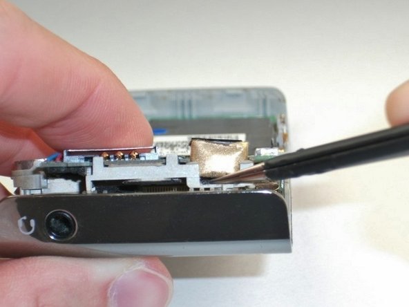

  8. LG Incite Camera Replacement: crwdns2935265:08crwdnd2935265:01crwdnd2935265:03crwdne2935265:0 LG Incite Camera Replacement: crwdns2935265:08crwdnd2935265:02crwdnd2935265:03crwdne2935265:0 LG Incite Camera Replacement: crwdns2935265:08crwdnd2935265:03crwdnd2935265:03crwdne2935265:0
    • Carefully slide the metal tweezers underneath the camera in order to lift it out.
    • Do not puncture the gold lining surrounding the camera.
    • The camera is glued in place, so there may be a slight resistance.
