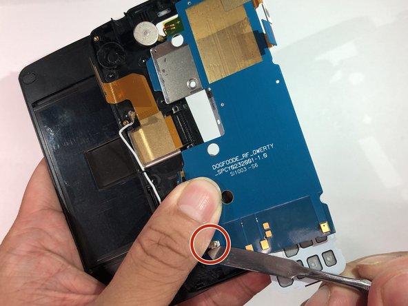

  10. LG GW910 Keyboard Replacement: crwdns2935265:010crwdnd2935265:01crwdnd2935265:02crwdne2935265:0 LG GW910 Keyboard Replacement: crwdns2935265:010crwdnd2935265:02crwdnd2935265:02crwdne2935265:0
    • Pry off the board from the side using the metal spudger tool.
    • Disconnect the antenna.
