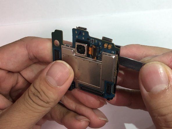

  8. LG GW910 Camera Replacement, Camera: crwdns2935265:08crwdnd2935265:01crwdnd2935265:02crwdne2935265:0 LG GW910 Camera Replacement, Camera: crwdns2935265:08crwdnd2935265:02crwdnd2935265:02crwdne2935265:0
    • Disconnect the connector using the metal spudger.
    • Peel back the tape on the side.
    • Replacement tape might be needed.

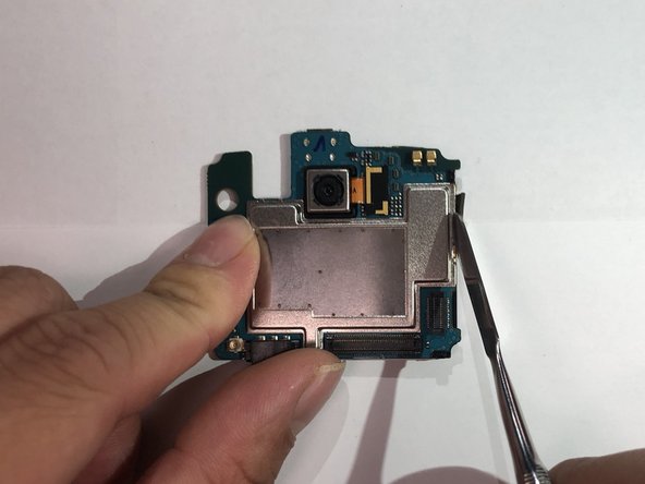

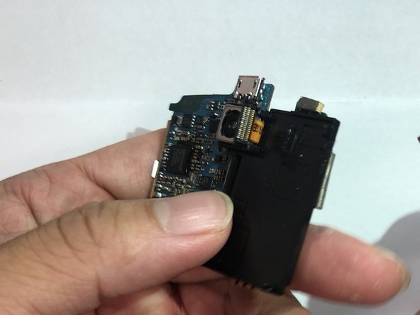

  9. LG GW910 Camera Replacement: crwdns2935265:09crwdnd2935265:01crwdnd2935265:03crwdne2935265:0 LG GW910 Camera Replacement: crwdns2935265:09crwdnd2935265:02crwdnd2935265:03crwdne2935265:0 LG GW910 Camera Replacement: crwdns2935265:09crwdnd2935265:03crwdnd2935265:03crwdne2935265:0
    • Pry open the two plastic hooks using the metal spudger tool.
    • Crack open the black plastic cover using the metal spudger tool. The cover should be easily turned over.
    • The connector might get stuck in the opening while turning over the cover. Twist the connector if needed.

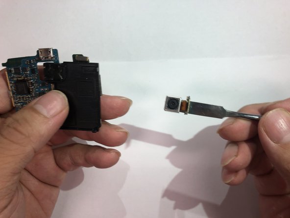

  10. LG GW910 Camera Replacement: crwdns2935265:010crwdnd2935265:01crwdnd2935265:02crwdne2935265:0 LG GW910 Camera Replacement: crwdns2935265:010crwdnd2935265:02crwdnd2935265:02crwdne2935265:0
    • Remove the camera unit by prying on it.
    • Adhesive will be needed for reassembly.
