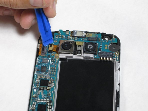

    1. LG G5 Rear Camera Replacement, Rear Camera: crwdns2935265:07crwdnd2935265:01crwdnd2935265:03crwdne2935265:0 LG G5 Rear Camera Replacement, Rear Camera: crwdns2935265:07crwdnd2935265:02crwdnd2935265:03crwdne2935265:0 LG G5 Rear Camera Replacement, Rear Camera: crwdns2935265:07crwdnd2935265:03crwdnd2935265:03crwdne2935265:0
      • Insert the plastic opening tool between the camera-ribbon connector and the motherboard, then pull up. It should pop out easily.
    2. LG G5 Rear Camera Replacement: crwdns2935265:08crwdnd2935265:01crwdnd2935265:02crwdne2935265:0 LG G5 Rear Camera Replacement: crwdns2935265:08crwdnd2935265:02crwdnd2935265:02crwdne2935265:0
      • After detaching the ribbon, carefully remove the camera using tweezers

This worked great and took me about 10 minutes!
Mark - crwdns2934203:0crwdne2934203:0 crwdns2950251:0crwdne2950251:0
Great instructions. This was my first time taking apart any phone. Everything went smoothly and my camera now works! thank you
Christopher Piatt - crwdns2934203:0crwdne2934203:0 crwdns2950251:0crwdne2950251:0
the camera is held down with sticky tape and I wasn’t comfortable pulling hard under the processing board, so I pulled the six screws holding that down and removed it first. Unfortunately for me the new camera still doesn’t focus…
Ray White - crwdns2934203:0crwdne2934203:0 crwdns2950251:0crwdne2950251:0
This worked great for me. I was a little nervous prying on my phone, especially when I heard the first POP. But after that, it was not hard at all. The new camera focuses great for me now and I can get back to taking great pictures with my G5!
Thanks for the detailed instructions, tools and affordable part!
Brad - crwdns2934203:0crwdne2934203:0 crwdns2950251:0crwdne2950251:0
You may want to mention that the original camera is glued in. It takes a bit of prying to pop it out.
Ryan - crwdns2934203:0crwdne2934203:0 crwdns2950251:0crwdne2950251:0
