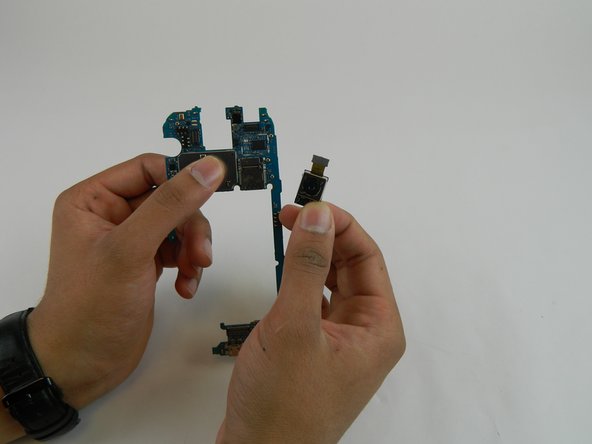

    1. LG G4 Rear Camera Replacement, Rear Camera: crwdns2935265:07crwdnd2935265:01crwdnd2935265:02crwdne2935265:0 LG G4 Rear Camera Replacement, Rear Camera: crwdns2935265:07crwdnd2935265:02crwdnd2935265:02crwdne2935265:0
      • Gently wedge the plastic opening tool under the ribbon where the rear camera cable is connected, and slowly lift up to detach the cable from the mother board.

I preformed this replacement on my LG G4 and found it to be very easy. However, between Steps 5 and 6, I will note a Warning...My camera was firmly attached to the frame with double sided tape. I simply removed the cable connector for the camera prior to lifting the Motherboard off of the frame (Step 6) and then pried the camera off of the frame using the spudger tool. I was able to reuse the tape on the replacement camera.
