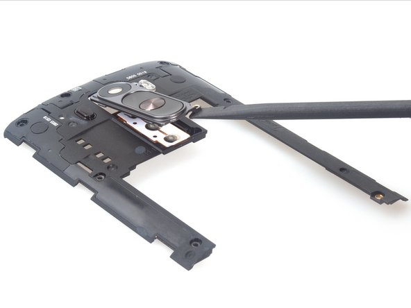

      • Remove the last screw attaching the rear camera lens to the frame.
      • Now use a plastic spudger to carefully remove the camera lens.

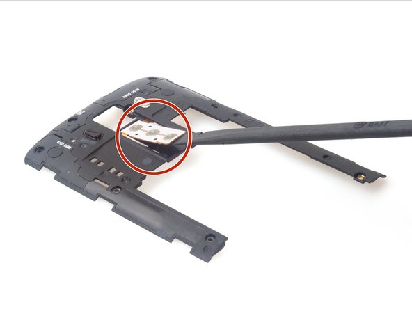

      • Using the spudger, release power & volume button flex from adhesive carefully.

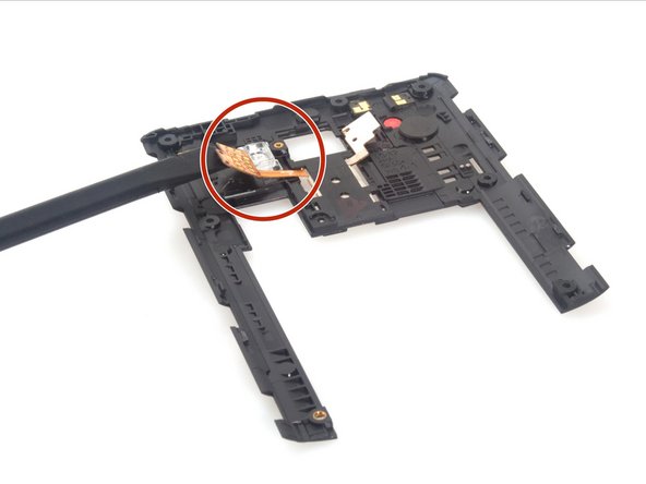

    3. LG G3 Power & Volume Button Cable Replacement: crwdns2935265:013crwdnd2935265:01crwdnd2935265:01crwdne2935265:0
      • Finally, remove the flex.
