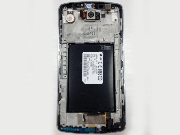

      • Power off your phone before beginning disassembly.
      • Insert a thumbnail, or a prying tool like a spudger, into the notch at the bottom left of the back cover.
      • Pry the back cover up to separate its plastic clips.
    2. LG G3 Front Facing Camera Replacement: crwdns2935265:02crwdnd2935265:01crwdnd2935265:02crwdne2935265:0 LG G3 Front Facing Camera Replacement: crwdns2935265:02crwdnd2935265:02crwdnd2935265:02crwdne2935265:0
      • Lift the back cover to release the rest of the plastic clips and remove it.
      • In case you can't lift the back cover completely, slide your fingernail or your prying tool around the midframe to release the remaining clips.
      • To reinstall the back cover, press it firmly into place until you hear a snap from the plastic clips to form a seamless connection with the rear side of the phone.
    1. LG G3 Front Facing Camera Replacement, Battery: crwdns2935265:03crwdnd2935265:01crwdnd2935265:02crwdne2935265:0 LG G3 Front Facing Camera Replacement, Battery: crwdns2935265:03crwdnd2935265:02crwdnd2935265:02crwdne2935265:0
      • Use a fingernail or a prying tool at the marked notch to lever the battery out of its recess.
    2. LG G3 Front Facing Camera Replacement: crwdns2935265:04crwdnd2935265:01crwdnd2935265:02crwdne2935265:0 LG G3 Front Facing Camera Replacement: crwdns2935265:04crwdnd2935265:02crwdnd2935265:02crwdne2935265:0
      • Lift the battery out of its recess and remove it.
    1. LG G3 Front Facing Camera Replacement, Loudspeaker: crwdns2935265:05crwdnd2935265:01crwdnd2935265:01crwdne2935265:0

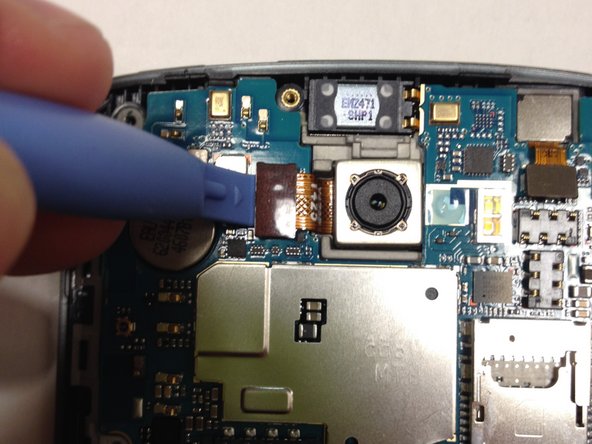

    1. LG G3 Front Facing Camera Replacement, Front Facing Camera: crwdns2935265:011crwdnd2935265:01crwdnd2935265:01crwdne2935265:0
      • Check to see that the ribbon cable is connected properly. If it was not, connect it and see if the front-facing camera now functions as intended. Otherwise, proceed
      • Take the plastic opening tool and gently wedge it under where the ribbon cable is connected
      • Gently lift up to disconnect the ribbon cable
    2. LG G3 Front Facing Camera Replacement: crwdns2935265:012crwdnd2935265:01crwdnd2935265:03crwdne2935265:0 LG G3 Front Facing Camera Replacement: crwdns2935265:012crwdnd2935265:02crwdnd2935265:03crwdne2935265:0 LG G3 Front Facing Camera Replacement: crwdns2935265:012crwdnd2935265:03crwdnd2935265:03crwdne2935265:0
      • Repeat the same process for the other 3 ribbon cables connected to the motherboard
    3. LG G3 Front Facing Camera Replacement: crwdns2935265:013crwdnd2935265:01crwdnd2935265:02crwdne2935265:0 LG G3 Front Facing Camera Replacement: crwdns2935265:013crwdnd2935265:02crwdnd2935265:02crwdne2935265:0
      • Remove the motherboard by lifting gently
      • Take care not to damage the ribbon cables if the other components are functional. Damaging them may result in other components not working
    4. LG G3 Front Facing Camera Replacement: crwdns2935265:014crwdnd2935265:01crwdnd2935265:01crwdne2935265:0
      • Take the plastic opening tool and remove the front-facing camera by wedging it into the sides and under the ribbon cable and lifting up
      • The front-facing camera is kept in place with an adhesive, so it may take some time and effort to get it out. Depending on how much force you are using, it may also be launched across the room
    5. LG G3 Front Facing Camera Replacement: crwdns2935265:015crwdnd2935265:01crwdnd2935265:01crwdne2935265:0
      • Remove the old front-facing camera

Naoto,
Thank you for the detailed guide it was very satisfying to repair this on my own.
please note: Image # 10 through me off for a few moments, until I realized it it was posted in mirror image mode.
For any one wanting to try this fix, I say “Go For It”
Also good to note: on my LG G3 . Once the back cover was removed, the inside back plate, comes apart in two sections the bottom 1/3 ( starting at the USB Charging port) is the first section that came apart.
Then the top section (starting beside the mid section of the battery housing) comes off easily.
Once completely removed, it was very easy to spot that the front facing camera ribbon connector just needed to be reset.
My phone feels brand new again :)
Again thank you
The Fix it Dude ,Fabian
