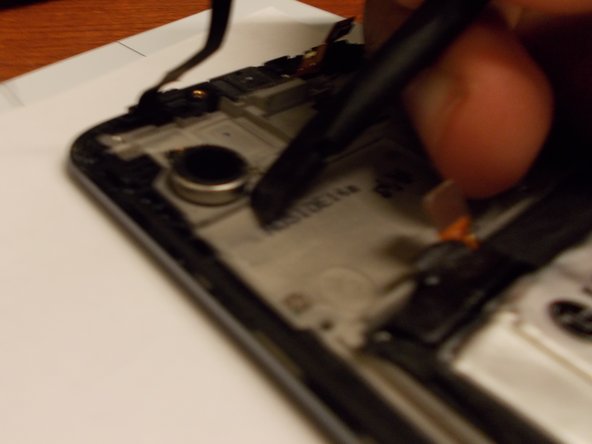

  11. LG G2 Vibrator Motor Replacement, Vibrator Motor: crwdns2935265:011crwdnd2935265:01crwdnd2935265:02crwdne2935265:0 LG G2 Vibrator Motor Replacement, Vibrator Motor: crwdns2935265:011crwdnd2935265:02crwdnd2935265:02crwdne2935265:0
    • This is a picture of the location of the vibrator motor.
    • It may require some prying due to the cohesive material used to hold it down so be gentle when removing.
    • Make use of spudger.
