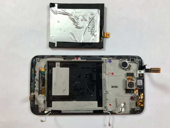

  8. LG G2 Sprint Battery Replacement, Battery: crwdns2935265:08crwdnd2935265:01crwdnd2935265:02crwdne2935265:0 LG G2 Sprint Battery Replacement, Battery: crwdns2935265:08crwdnd2935265:02crwdnd2935265:02crwdne2935265:0
    • Now you are ready to remove the battery. Make sure to adhere to ESD prevention guidelines, use a plastic tool as to not damage the battery.
    • Start at the top left of the battery and slide your nylon Uspudger under the battery. There is a layer of adhesive that keeps the battery in the case. Use steady, firm pressure to pull the battery up. If the battery case begins to bend, you may need to use less force.

The adhesive holding my battery was a big pain to get through, definitely go slow and carefully so you don’t damage the battery.
Cresny - crwdns2934203:0crwdne2934203:0
Agree with Cresny on the adhesive. So strong in my case, and it required patience and steady, medium pressure to get it to release.
Added comments to some steps in the guide, and feel it’s overall lacking some info. I stopped referring to it around Step 5 because of this. (If this was my first go at a battery swap I’d have been frustrated; luckily it was my third.) But how many more people will try to replace a battery in a 2013 phone in 2020 and beyond? Probably not many! :-)
No special screw head sizes were needed to remove all 12 screws. I used the very typical Phillips 00 that people use on teeny electronics screws and it worked great. Take your time, pay attention and look at all attachments so you don’t miss any!
This is the only phone I had to do a soft reset on after changing the battery. If you don’t get beyond the LG logo screen when you test it before putting it back together, hold the Power button and Volume Down button down together for 10–12 seconds until you see the logo appear.
