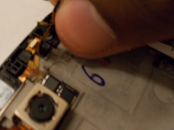

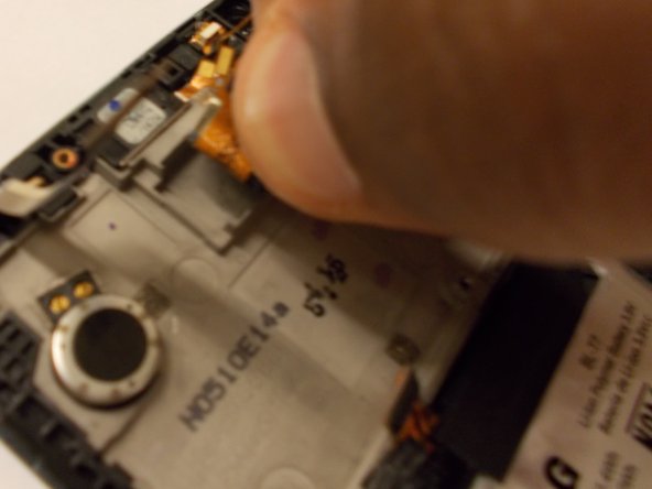

  11. LG G2 Camera Replacement, Camera: crwdns2935265:011crwdnd2935265:01crwdnd2935265:02crwdne2935265:0 LG G2 Camera Replacement, Camera: crwdns2935265:011crwdnd2935265:02crwdnd2935265:02crwdne2935265:0
    • Front camera is located on the top right.
    • To remove the front camera simply grab the connector and pull out.
  12. LG G2 Camera Replacement: crwdns2935265:012crwdnd2935265:01crwdnd2935265:02crwdne2935265:0 LG G2 Camera Replacement: crwdns2935265:012crwdnd2935265:02crwdnd2935265:02crwdne2935265:0
    • Back camera is located top middle.
    • Use spudger to pry away, and gently remove the camera.
