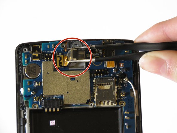

  6. LG G Vista Motherboard Replacement: crwdns2935265:06crwdnd2935265:01crwdnd2935265:01crwdne2935265:0
    • Use a pair of tweezers to lift up the white antenna wire. On the other side of the logic board, do the same for the black antenna wire.
  7. LG G Vista Motherboard Replacement: crwdns2935265:07crwdnd2935265:01crwdnd2935265:02crwdne2935265:0 LG G Vista Motherboard Replacement: crwdns2935265:07crwdnd2935265:02crwdnd2935265:02crwdne2935265:0
    • Use the tweezers to remove the four connectors as well as the back camera.
    • Be careful not to directly touch the camera lenses.
  8. LG G Vista Motherboard Replacement: crwdns2935265:08crwdnd2935265:01crwdnd2935265:01crwdne2935265:0
    • Lift up and remove the motherboard from the device.
