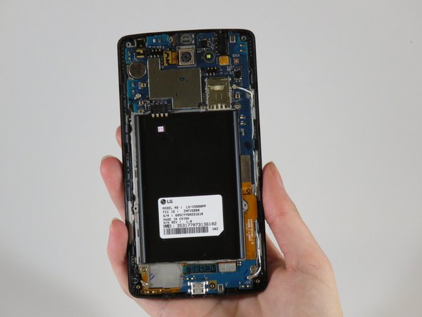

    • Make sure the device is powered off.
  2. LG G Vista Charging Dock Replacement: crwdns2935265:02crwdnd2935265:01crwdnd2935265:01crwdne2935265:0
    • Remove the back cover by gently prying open the case of the device from the charging port.
  3. LG G Vista Charging Dock Replacement: crwdns2935265:03crwdnd2935265:01crwdnd2935265:01crwdne2935265:0
    • Lift the battery out of its place by prying up from the small notch at the base of the battery.
  4. LG G Vista Charging Dock Replacement, Charging Dock: crwdns2935265:04crwdnd2935265:01crwdnd2935265:01crwdne2935265:0
    • Using a Phillips #000 screwdriver, remove the eleven 3.0 mm screws around the perimeter of the phone.
  5. LG G Vista Charging Dock Replacement: crwdns2935265:05crwdnd2935265:01crwdnd2935265:01crwdne2935265:0
    • Use a plastic spudger, or finger nail, to lift up the hard shell on the top of the phone.
  6. LG G Vista Charging Dock Replacement: crwdns2935265:06crwdnd2935265:01crwdnd2935265:02crwdne2935265:0 LG G Vista Charging Dock Replacement: crwdns2935265:06crwdnd2935265:02crwdnd2935265:02crwdne2935265:0
    • Use a Phillips #000 screwdriver to remove the five 3.0 mm screws.
    • Remove the bottom hard shell from the device.
  7. LG G Vista Charging Dock Replacement: crwdns2935265:07crwdnd2935265:01crwdnd2935265:02crwdne2935265:0 LG G Vista Charging Dock Replacement: crwdns2935265:07crwdnd2935265:02crwdnd2935265:02crwdne2935265:0
    • Using a Phillips #000 screwdriver, remove the two screws from the device.
  8. LG G Vista Charging Dock Replacement: crwdns2935265:08crwdnd2935265:01crwdnd2935265:01crwdne2935265:0
    • Using a pair of tweezers, lift up the two antennas surrounding the battery.
  9. LG G Vista Charging Dock Replacement: crwdns2935265:09crwdnd2935265:01crwdnd2935265:01crwdne2935265:0
    • Disconnect the two connectors on the right side of the charging port.
  10. LG G Vista Charging Dock Replacement: crwdns2935265:010crwdnd2935265:01crwdnd2935265:01crwdne2935265:0
    • Lift up the charging port with the plastic opening tool.
    • Remove the charging port from the device.
