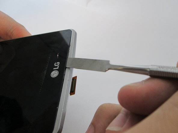

    1. LG G Stylo Glass Screen Replacement, Glass Screen: crwdns2935265:07crwdnd2935265:01crwdnd2935265:02crwdne2935265:0 LG G Stylo Glass Screen Replacement, Glass Screen: crwdns2935265:07crwdnd2935265:02crwdnd2935265:02crwdne2935265:0
      • Use the plastic opening tool to peel off the sticker.
    2. LG G Stylo Glass Screen Replacement: crwdns2935265:08crwdnd2935265:01crwdnd2935265:02crwdne2935265:0 LG G Stylo Glass Screen Replacement: crwdns2935265:08crwdnd2935265:02crwdnd2935265:02crwdne2935265:0
      • Gently use the plastic opening tool to set the tab free. This tab is used to hold the screen in place.
    3. LG G Stylo Glass Screen Replacement: crwdns2935265:09crwdnd2935265:01crwdnd2935265:02crwdne2935265:0 LG G Stylo Glass Screen Replacement: crwdns2935265:09crwdnd2935265:02crwdnd2935265:02crwdne2935265:0
      • The screen is held with adhesive, so use the iOpener to apply heat to the device.
      • Once you applied the iOpener on the device, use the plastic opening tool or opening pick to pry the screen free.
      • When working with electronics, it's important to use ESD-safe tools to avoid accidental damage to the device. The regular black nylon spudger or a plastic opening tool should be used whenever possible. Also, beware of sharp edges on a broken screen.
      • Once the broken screen has been set free, put in the screen replacement.

Your guide was clear and the photos were good up until removing and replacing the glass, which is the title of this guide. Was the screen glued onto the LCD? Did you have to replace the LCD and glass or just the glass? How did you remove the glass from the LCD? Did you have to glue the glass back to the LCD screen or use adhesive tape? I'm asking because I don't know if this is a DIY job or if I should get the phone professionally repaired.
Pernickety Jon - crwdns2934203:0crwdne2934203:0 crwdns2950251:0crwdne2950251:0
True, missing important details. I'm about to do this replacement. I assume the replacement screen has dual side tape built in. I'll report back soon.
joscomsu - crwdns2934203:0crwdne2934203:0 crwdns2950251:0crwdne2950251:0
It seems the tutorial is for the whole screen (LCD+Glass) and it pretty much covers everything. After removing the screen, it's just a matter of replacing it with the new one.
My experience: I bought the whole screen and mine came without any adhesives, so I had to use a double sided tape I got previously for another screen. It's a very thin black tape and while I've read that it is not recommended, it held the screen in place. Although I am worried that it might be a bit weak for the long run. Also, it didn't came with the speaker grill, so I had to use the one from the broken screen. Remember this before installing the new one.
