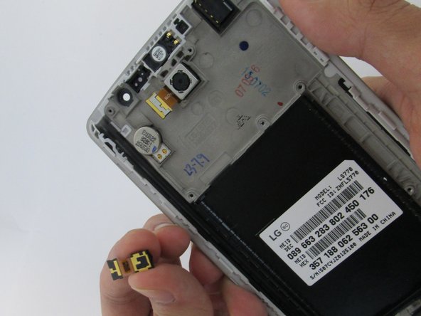

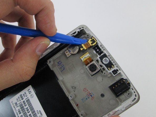

  7. LG G Stylo Front Camera Replacement, Front Camera: crwdns2935265:07crwdnd2935265:01crwdnd2935265:03crwdne2935265:0 LG G Stylo Front Camera Replacement, Front Camera: crwdns2935265:07crwdnd2935265:02crwdnd2935265:03crwdne2935265:0 LG G Stylo Front Camera Replacement, Front Camera: crwdns2935265:07crwdnd2935265:03crwdnd2935265:03crwdne2935265:0
    • Indicated on the back of the phone is the front camera. To remove the front camera, detach the ribbon cable located on the back of the phone at the top-left.
    • Gently lift up the ribbon with the plastic opening tool. Remove the front camera and replace accordingly.
    • Be careful when removing to avoid harming the device and tearing the attached ribbon.
