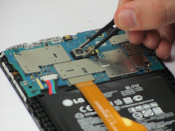

    • Use the plastic opening tool to pry up the ribbon cable connecting to the camera unit.
    • One the ribbon cable has been detached, use the tweezers to pull up the camera. It is attached with adhesive so pull up gently to remove it.
    • Once the old camera unit is removed, replace with new unit and reassemble in reverse order of guide.

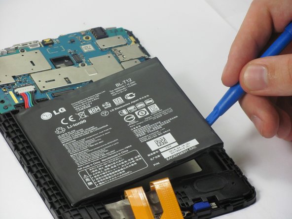

    • Use the plastic opening tool to pry the multicolor wire cables off, applying force up away from the tablet.
    • Use the plastic opening tool to pry up the battery. There is adhesive underneath the battery, so use a small amount of force. Work your way around the edge of the battery to pry it off.

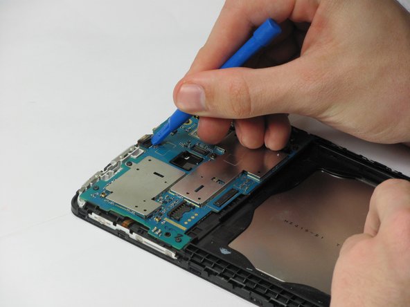

    • Locate the front facing camera ribbon cable attachment on the motherboard
    • Leave the ribbon cable disconnected.

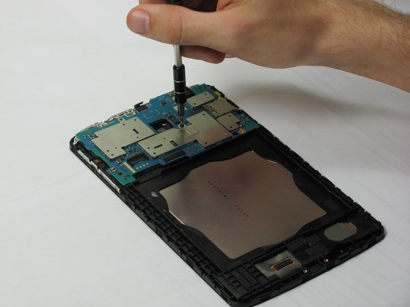

    • Locate the six Phillips head screws on the LG G Pad F 7.0 Motherboard
    • Use Phillips #0 Screwdriver to unscrew the six screws.

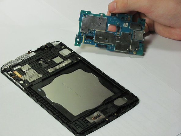

    • Remove the motherboard by prying it out with the plastic opening tool (as shown in image).
