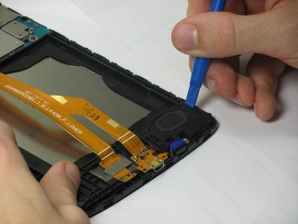

  4. LG G Pad F 7.0 Charging Port  Replacement: crwdns2935265:04crwdnd2935265:01crwdnd2935265:02crwdne2935265:0 LG G Pad F 7.0 Charging Port  Replacement: crwdns2935265:04crwdnd2935265:02crwdnd2935265:02crwdne2935265:0
    • Remove the gyroscope (the blue rectangular cube) located near the bottom of the device with the plastic opening tool as shown in the image.
    • Remove the speaker located in the bottom right corner of the device with the plastic opening tool as shown in the image.

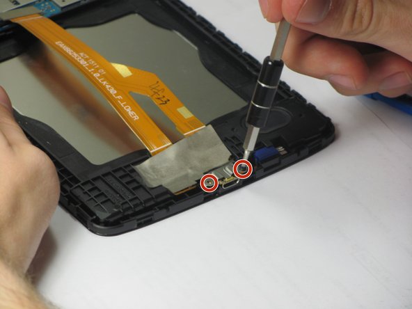

  5. LG G Pad F 7.0 Charging Port  Replacement: crwdns2935265:05crwdnd2935265:01crwdnd2935265:02crwdne2935265:0 LG G Pad F 7.0 Charging Port  Replacement: crwdns2935265:05crwdnd2935265:02crwdnd2935265:02crwdne2935265:0
    • Remove the two screws located on the charging port as seen in the image using the Phillips screwdriver.
    • Using the tweezers, remove the orange ribbon cable along with the charging port.

Just a minor item. On step 4 it tells you to remove the gyroscope, then remove the speaker. On on the unit I worked in you had to remove the speaker so you could get remove the gyroscope. I was working on the 8.0 instead of the 7.0 model, so perhaps that accounted for the difference.
