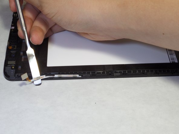

  4. LG G Pad 8.3 Volume Control Buttons Replacement, Volume Control Buttons: crwdns2935265:04crwdnd2935265:01crwdnd2935265:02crwdne2935265:0 LG G Pad 8.3 Volume Control Buttons Replacement, Volume Control Buttons: crwdns2935265:04crwdnd2935265:02crwdnd2935265:02crwdne2935265:0
    • With the screen facing towards you and the top of the tablet towards your left, locate the volume buttons on the left side.
    • Using a spudger or your hands, remove the volume control buttons, which are attached with adhesive.
