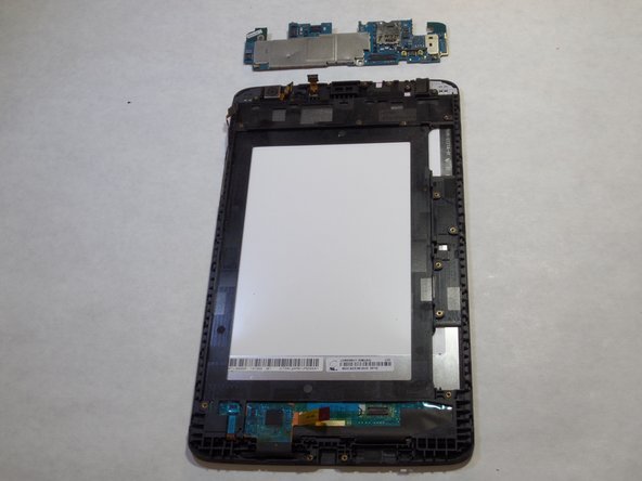

  11. LG G Pad 8.3 Rear Facing Camera Replacement: crwdns2935265:011crwdnd2935265:01crwdnd2935265:01crwdne2935265:0
    • Remove all the 3mm silver screws and the 2mm black screws on the motherboard and carefully lift it out of the device.
  12. LG G Pad 8.3 Rear Facing Camera Replacement: crwdns2935265:012crwdnd2935265:01crwdnd2935265:02crwdne2935265:0 LG G Pad 8.3 Rear Facing Camera Replacement: crwdns2935265:012crwdnd2935265:02crwdnd2935265:02crwdne2935265:0
    • Use a plastic opening tool to lift the motherboard out of the device.
    • These images use a metal spudger, which has the potential to damage the device. Use a plastic opening tool or standard spudger instead.

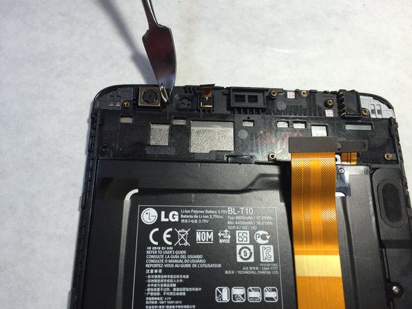

  13. LG G Pad 8.3 Rear Facing Camera Replacement, Rear Facing Camera: crwdns2935265:013crwdnd2935265:01crwdnd2935265:02crwdne2935265:0 LG G Pad 8.3 Rear Facing Camera Replacement, Rear Facing Camera: crwdns2935265:013crwdnd2935265:02crwdnd2935265:02crwdne2935265:0
    • Use a plastic opening tool to remove the camera, which is attached with adhesive to the front of the tablet.
