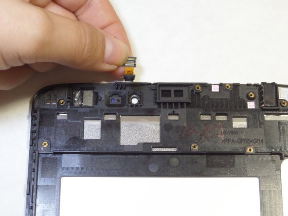

  13. LG G Pad 8.3 Front Facing Camera Replacement, Front Facing Camera: crwdns2935265:013crwdnd2935265:01crwdnd2935265:02crwdne2935265:0 LG G Pad 8.3 Front Facing Camera Replacement, Front Facing Camera: crwdns2935265:013crwdnd2935265:02crwdnd2935265:02crwdne2935265:0
    • Use a plastic opening tool to lift the front facing camera out of the device.
    • These images use a metal spudger, which has the potential to damage the device. Use a plastic opening tool or standard spudger instead.
