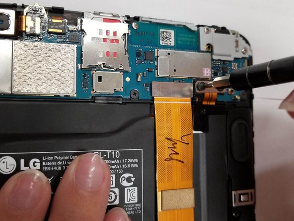

    • Put the spudger underneath the gold cap of the cable and lift to disconnect from device.
    • This cable can be damaged easily.

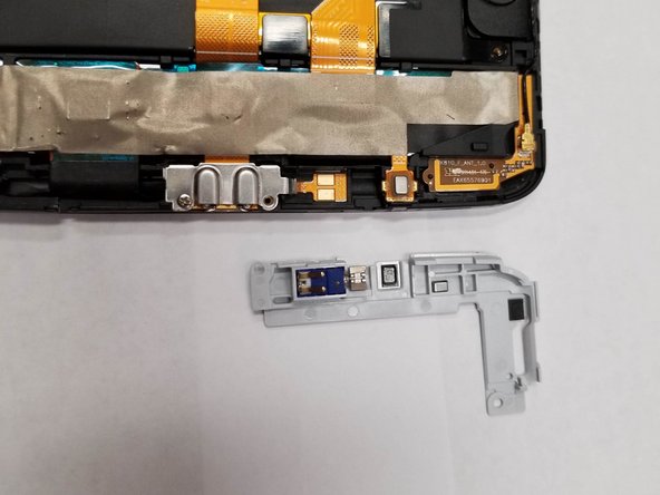

  7. LG G Pad 8.3 4G Battery Replacement, Vibrator: crwdns2935265:07crwdnd2935265:01crwdnd2935265:02crwdne2935265:0 LG G Pad 8.3 4G Battery Replacement, Vibrator: crwdns2935265:07crwdnd2935265:02crwdnd2935265:02crwdne2935265:0
    • Remove the two screws on the white panel on the bottom right side.
  8. LG G Pad 8.3 4G Battery Replacement: crwdns2935265:08crwdnd2935265:01crwdnd2935265:02crwdne2935265:0 LG G Pad 8.3 4G Battery Replacement: crwdns2935265:08crwdnd2935265:02crwdnd2935265:02crwdne2935265:0
    • Remove the white panel.
  9. LG G Pad 8.3 4G Battery Replacement: crwdns2935265:09crwdnd2935265:01crwdnd2935265:01crwdne2935265:0
    • Remove the vibrator from the underside of the white panel.

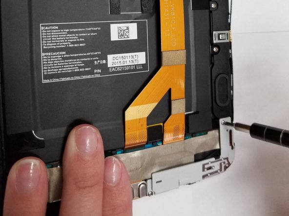

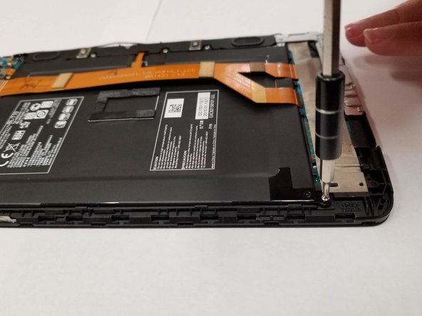

    • Remove the 3 silver 1.5 mm screws that remain.
  11. LG G Pad 8.3 4G Battery Replacement: crwdns2935265:011crwdnd2935265:01crwdnd2935265:02crwdne2935265:0 LG G Pad 8.3 4G Battery Replacement: crwdns2935265:011crwdnd2935265:02crwdnd2935265:02crwdne2935265:0
    • Remove the 2 black 1.5 mm screws.

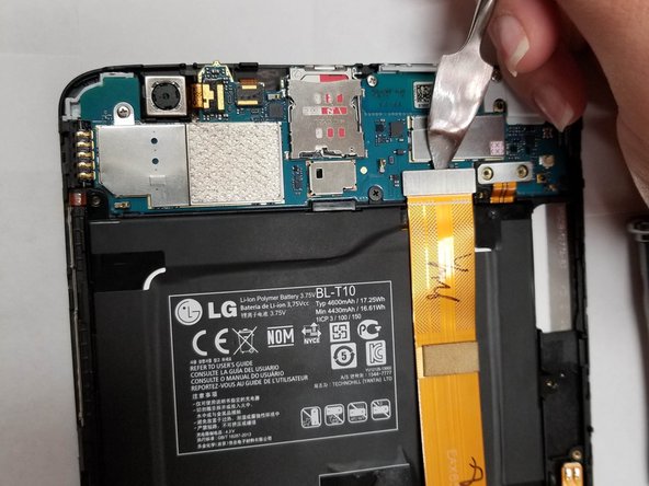

    • Insert metal spudger under the side of the gold strip and pull.
  13. LG G Pad 8.3 4G Battery Replacement: crwdns2935265:013crwdnd2935265:01crwdnd2935265:02crwdne2935265:0 LG G Pad 8.3 4G Battery Replacement: crwdns2935265:013crwdnd2935265:02crwdnd2935265:02crwdne2935265:0
    • Place spudger under the top of the gold bar and gently pry up.
  14. LG G Pad 8.3 4G Battery Replacement: crwdns2935265:014crwdnd2935265:01crwdnd2935265:01crwdne2935265:0
    • Pull on top of the silver block until gold bar lifts.
